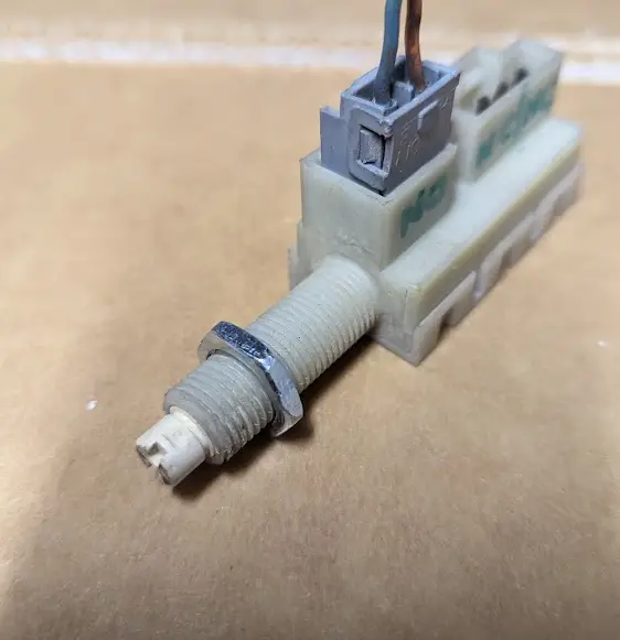

That clip sucks. I ended up putting nuts onto the switch to keep it from moving and engaging the brake lights.
If you remember the size please let me know I’m missing the retainer and it keeps moving
What size nuts?
They're 1/4-18. Here's one on mine. These are a common thread in the lighting industry (that I work in) & I have these at my work. I'll send you a few (plus lockwashers) if you want, or if you want to buy your own, look in the lighting section of your big box hardware store. they usually have loose lighting hardware & should have some of these. They're known as "1/4 IPS" in the lighting world.

Thanks a lot for that information. And sure I’ll take some! If you already have the right ones and saves me from searching for them why not, long as the shipping is not too much!
