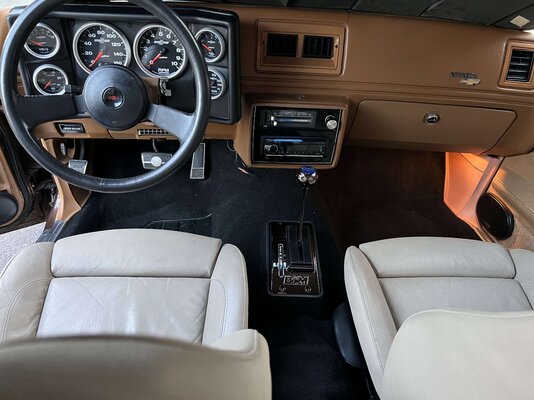

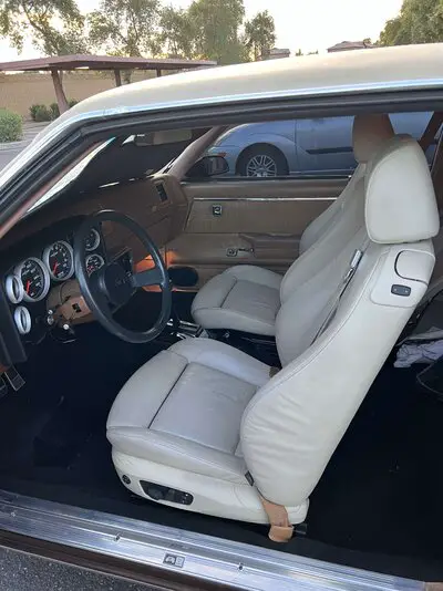

SS_Malibu
Sep 27, 2021
801
1,320
Mesa, AZ
I waited to mount my after market shifter until I had the seats mounted so I could be sure the shifter was exactly where I wanted it. I mounted it right to the floor with large washers to spread the load. It’s solid and secure.
Try that first before buying the shifter mount as you may not need it.
