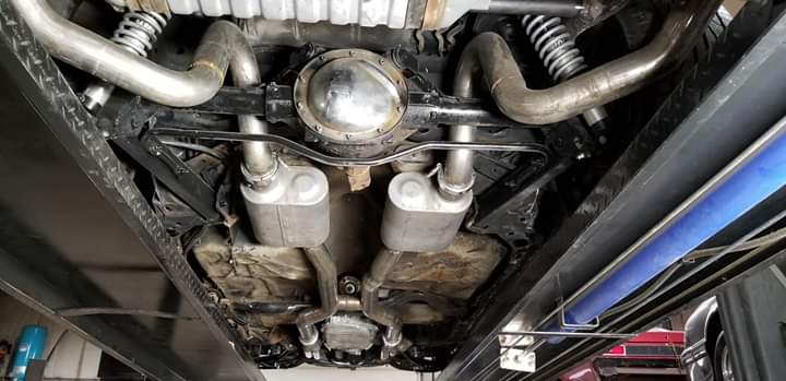

My Malibu runs down hellcats. I didn't build it for that but it's fun. Someone said something about the G not having all of the latest tech, that's exactly what I love about them.
Also the 6.2 vs smaller truck engines debate has positives in both directions. I would love to whip out a LS3 and beat on it like I do 5.3s. 4k++ for just the stock engine vs the $231 it costs me to get whatever the junkyard has is a strong incentive to keep with unloved truck engines.
4.8 is a special engine. It's one of a couple LS engines with a non-standard stroke. The hand built LS7 is the other outlier that sticks out. The short stroke of the 4.8 makes it ideal to use for a maximum effort boost platform. The smaller angle between the crank and piston pin makes it able to tolerate enormous cylinder pressures without folding up connecting rods. The magic of small block GM stuff is that all this junk interchanges. 4.8 crank in the LS3 FTW!! Big bore unshrouds the valves, short stroke keeps the rotating assembly stout. Ya could spin it to the Moon or compound turbo it and make 20lbs of boost at 1500rpm. Electric motor style torque but still makes cool noises. I need to figure out variable geometry turbos like diesel trucks use but on a much larger platform like s480 stuff. Boost at low rpm along with free flowing top end.
