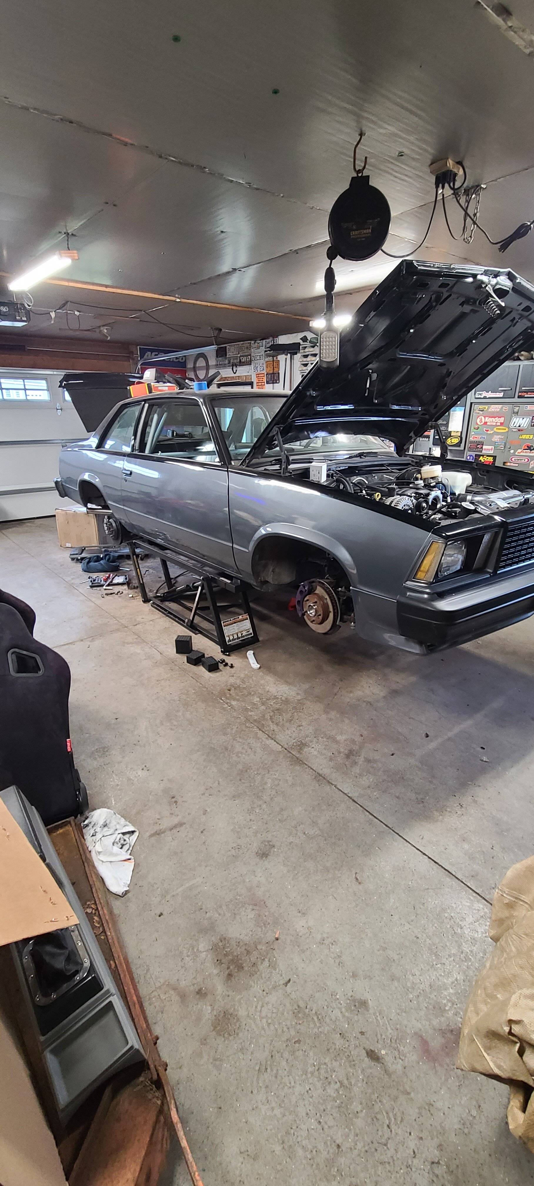

Quick Jack's. Allows service in the center of the vehicle too. Light enough to move around by yourself and can be stored upright against a wall.

Quick Jack's. Allows service in the center of the vehicle too. Light enough to move around by yourself and can be stored upright against a wall. View attachment 196154
They are a good home gamer solution.
Just put jack stands under the corners for added protection.
