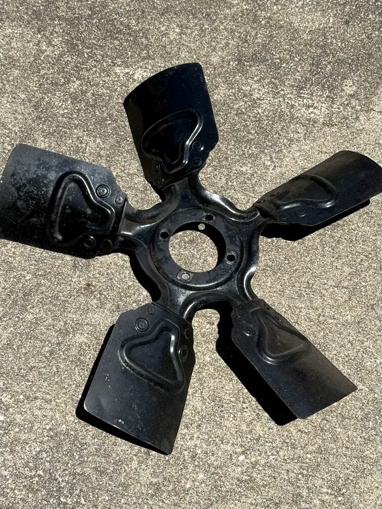

Thank you!5 blade. Looks uneven when you look at it. Not at home right now but when I do get home I’ll look up the part number

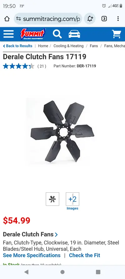

Thank you.I've gotten rid of the OEM blades, run these 19" 6 blades and Hayden SD clutch on clutch setup or solid hub version. I find they move more air when engaged and allow more air to pass through them when windmilling while cruising at speeds, downside, they're little louder than stock blades
Do have a 97 C3500HD with 20" version with Hayden fan clutch.
Ran both standard and reverse rotation versions.

Thank you.Stock stuff is just fine for a 307. 19" nominal size. Made by a company called "Brookside".

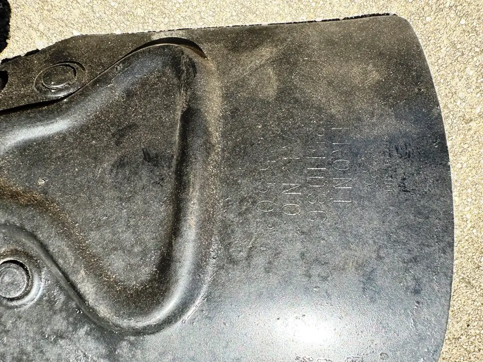

Part number for the fan is right on the blades. 22511036. Note the brookside stamping at the top.
