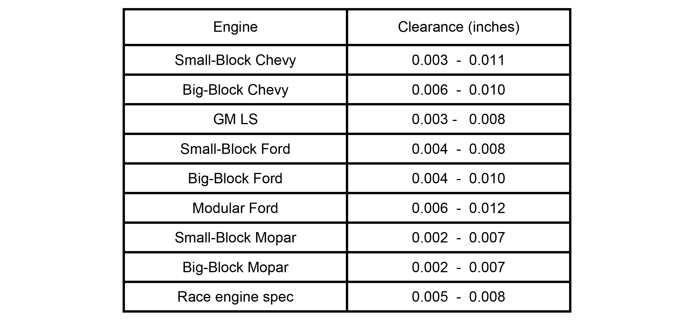

Well i did it quick, here’s my setup. I am measuring .007 with a 24” 2x3 between the crank and timing cover pulling parallel to the crank. I dont really like prying on the timing cover. Although it is a pretty stout unit. Not sure where else to get a bite. Does anyone know the tolerance? I had the wife push the clutch as well. This results in about .001

You said LT1 right? This one? read this articlel about the thrust surface. https://www.motortrend.com/how-to/ccrp-0909-lt1-engine-build/ Go to 18:10 minutes.
Thanks, yes 96 LT1. I guess that would fall under SBC. So my .007 should be good? About how hard should i be prying on the crank pulley? I *think* i am getting all the play but its a tight spot .. also i guess my next move is to pull the transmission. Hopefully i find something obvious in the bell housing area.
