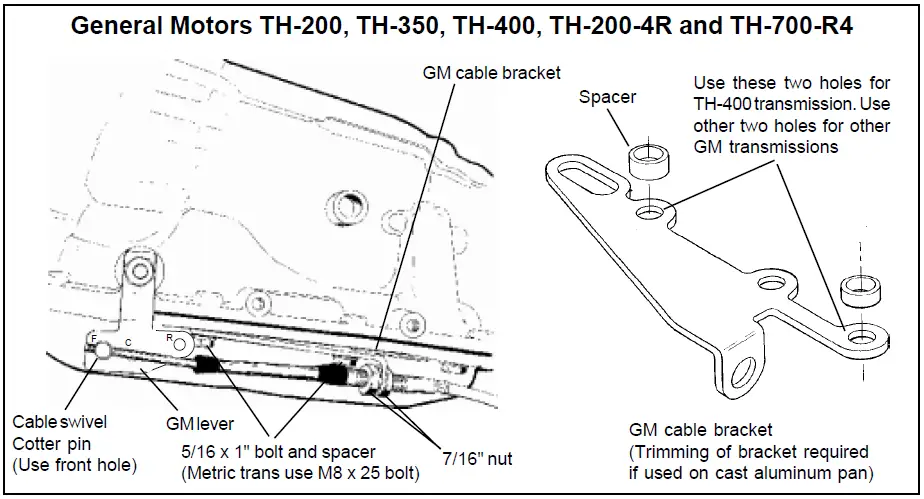

I am running a 4L80 in my car. I was able to use the transmission bracket and cable from a B&M shifter and connected to the shifter lever on the column in the engine bay with a bolt. It works great and I have use of all gears.
Do you have pics of your setup per chance? Did you just use the cable from a B&M shifter you already had?
I don't have any pictures at the moment but I will try to get my car on my lift and snap a few. I used the cable and bracket from a shifter I had for a 700R4. The drawing below shows the parts used on the transmission.
Hey bud, is there any chance you can snap a pic of how you have the cable attached to the shifter bracket on the column? I ended up getting the Lokar kit, but it’s a no go.
