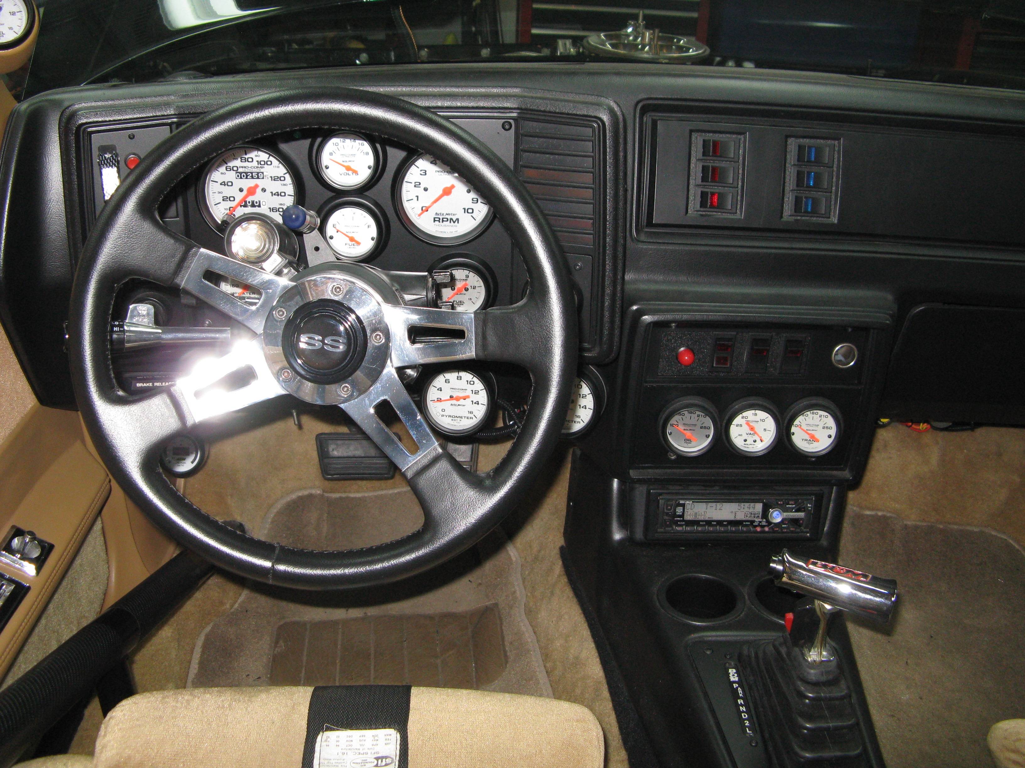

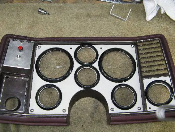

I gutted my Monte's gauge bezel and made removeable aluminum inserts for my gauges and mounted those with Rivnuts.
I also moved the radio down and added 3 gauges there and then installed a 2 gauge pillar pod for my nitrous gauges.
IMO the GP has the best dash layout for gauges but I wanted to make what I had work plus my dash is mint.
I also kept all of my factory idiot lights in place and working
