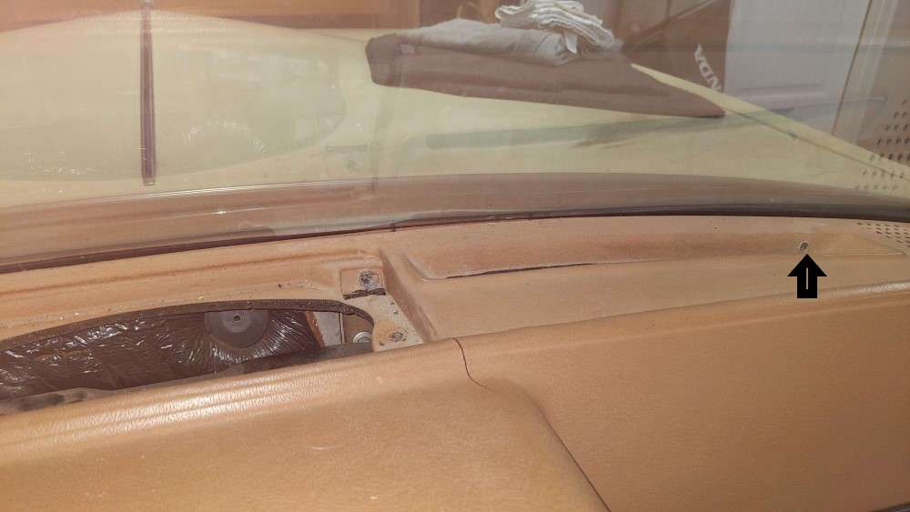

Hutch, I've already seen both of those, but I'm telling you there's a difference between my 79 and those two

OK ELCAM, I was convinced that maybe the fasteners were sheered off, because I couldn't see anything but foam looking down these holes. But decided to shove a philips head screwdriver down this hole and see if it'd latch on to anything. Sure enough it did. Those suckers were buried in there.
Did you get these? One on each side.
OK ELCAM, I was convinced that maybe the fasteners were sheered off, because I couldn't see anything but foam looking down these holes. But decided to shove a philips head screwdriver down this hole and see if it'd latch on to anything. Sure enough it did. Those suckers were buried in there! Thanks for the extra push!
Now the fun continues. Nice job!

I just posted to my tik tok and IG to explain further. I'm Str8sixfan there too. YouTube short version is clipped as there is a 60sec limit there, and I recorded 90secs
OK, here's the long form version of the video. Thanks for all the write ups in this thread. Super helpful. Used a lot of the tidbits from earlier posts. Found a few differences, so we can let this live on as a reference for others with an early production era Grand Prix -
