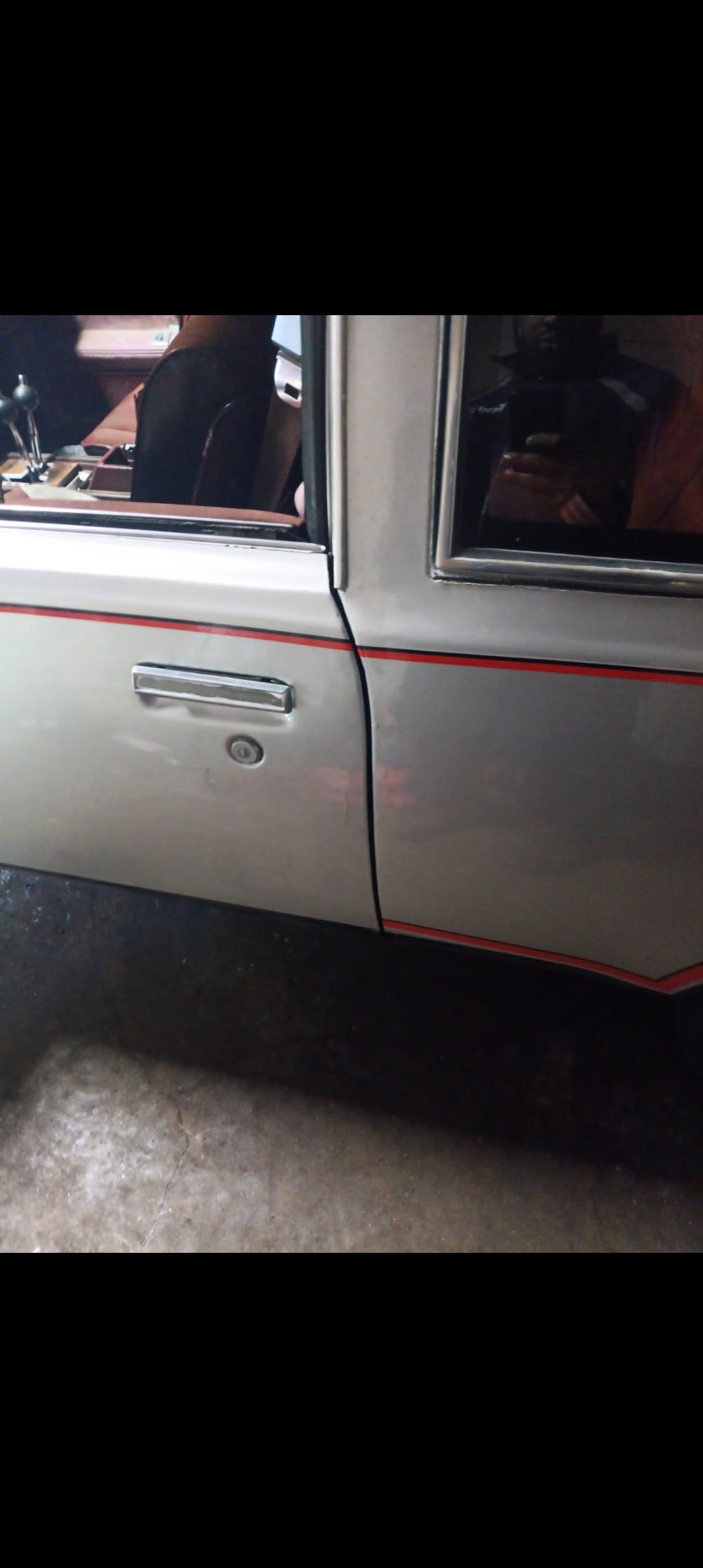

let me know how things look after you move the striker out and make sure the striker lines up center with the door latch. when closing. also you can try to pick up the very rear of the door to see how much wear is in the door bushings
These are new hinges and the driver door is looking pretty good so far. The height at the rear needs to come down and the front of the door needs to come up
did not know you put on new hinges they are a bear to line up the door and glass .ok move the front up to get the rear down you either move the top hinge rearward or the bottom hinge forward and there is in and out adjusting on both hinges each time you move it you need to realign the striker or remove it
