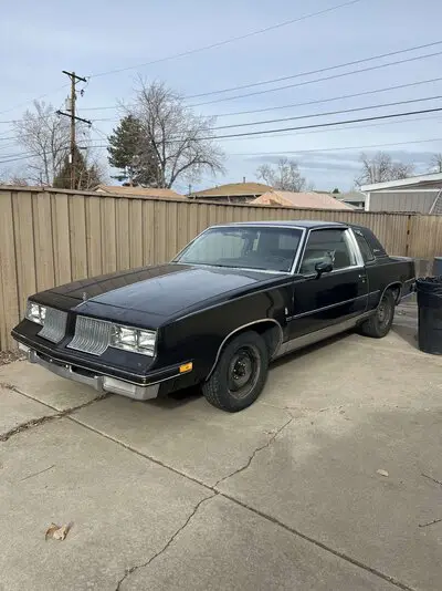

Preparing for my first engine swap on my 84 Cutlass Supreme. It has a 307 that I’m looking to swap for a new Blueprint 350 Long Block. Right now I’m in the very early planning phase. Trying to learn everything I can about what the swap entails from anything online, YouTube videos and small advice from my grandfather who lives 2 states away. Hopefully some advice and knowledge from some of the Gbody guys in this forum. This is definitely the biggest challenge of my very early mechanical journey with this Cutlass. My father had all the advice I would need about this project. He had a lot of experience fixing up Gbodys. He passed last year, and in a way this car is for him. I realize this will not be an easy task, definitely expensive and time consuming but, I’m only 29, good job, no kids, and an amazing wife that supports my dream. I have the time, I’m hungry to learn, and I’m fully determined to see this job through. Sorry for the life story. Im new to the site and I figured I’d be up front about my situation and my project. Any help, advice, or knowledge would be truly appreciated. Thank you.
