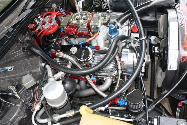

Hey Bob, my car was a V6 from the factory and only has the feed line on the pass side and the vent line to the canister on the drivers side. I thought about using the vent line for a return, but then not sure how to vent the tank. And yes, everyone tries to talk me into a Holley. I finally picked up a really nice used 750 vacuum secondary unit and ran it last summer when I had the 327 in the car. It ran good. With the 327, (around 300hp), there was no diff in ET between the Holley and a 600cfm Edelbrock. I might be getting to the tipping point though. I'm going to double check float levels to the high side and install some high flow needle and seats that I have but never installed to help the Edelbrock. I spent a lot of time tuning it for driveability and WOT and it is pretty spot on so I hate to abandon it for the Holley and start over.Greetings Mike & all; I used the OE return line & plumbed in a Mossoro regulating fuel log. It adjusts with various springs inserted into the check valve. As for you second 2nd gear problem, possibly the "G" force or small volume float bowl is not keep the main jets-rods covered during hard pull? That's one of the reasons many chose to run with Holley's? Ole' Bob. Ps; I ran 6-7 PIS at idle & 5-6 @ Full ON.
