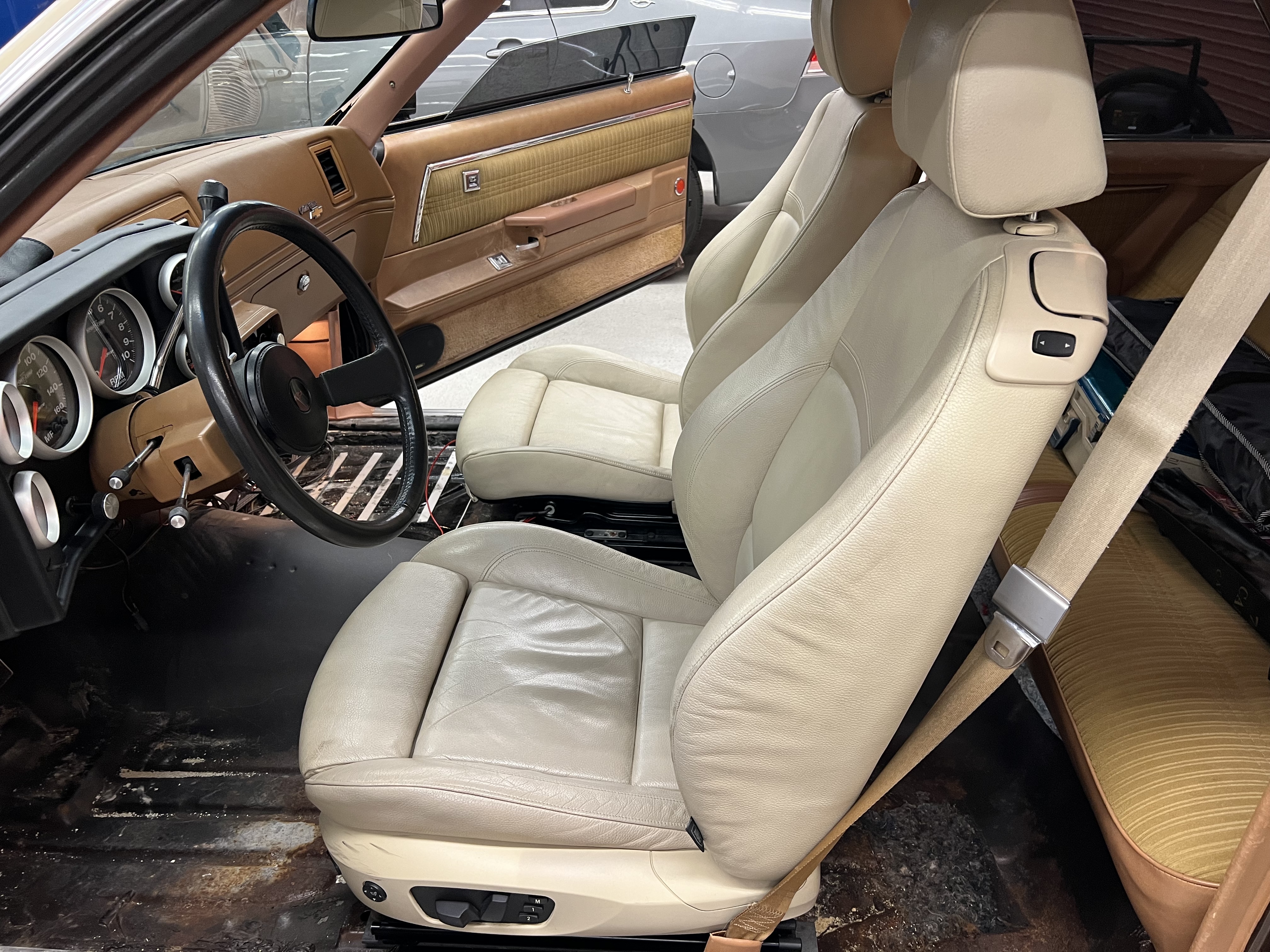

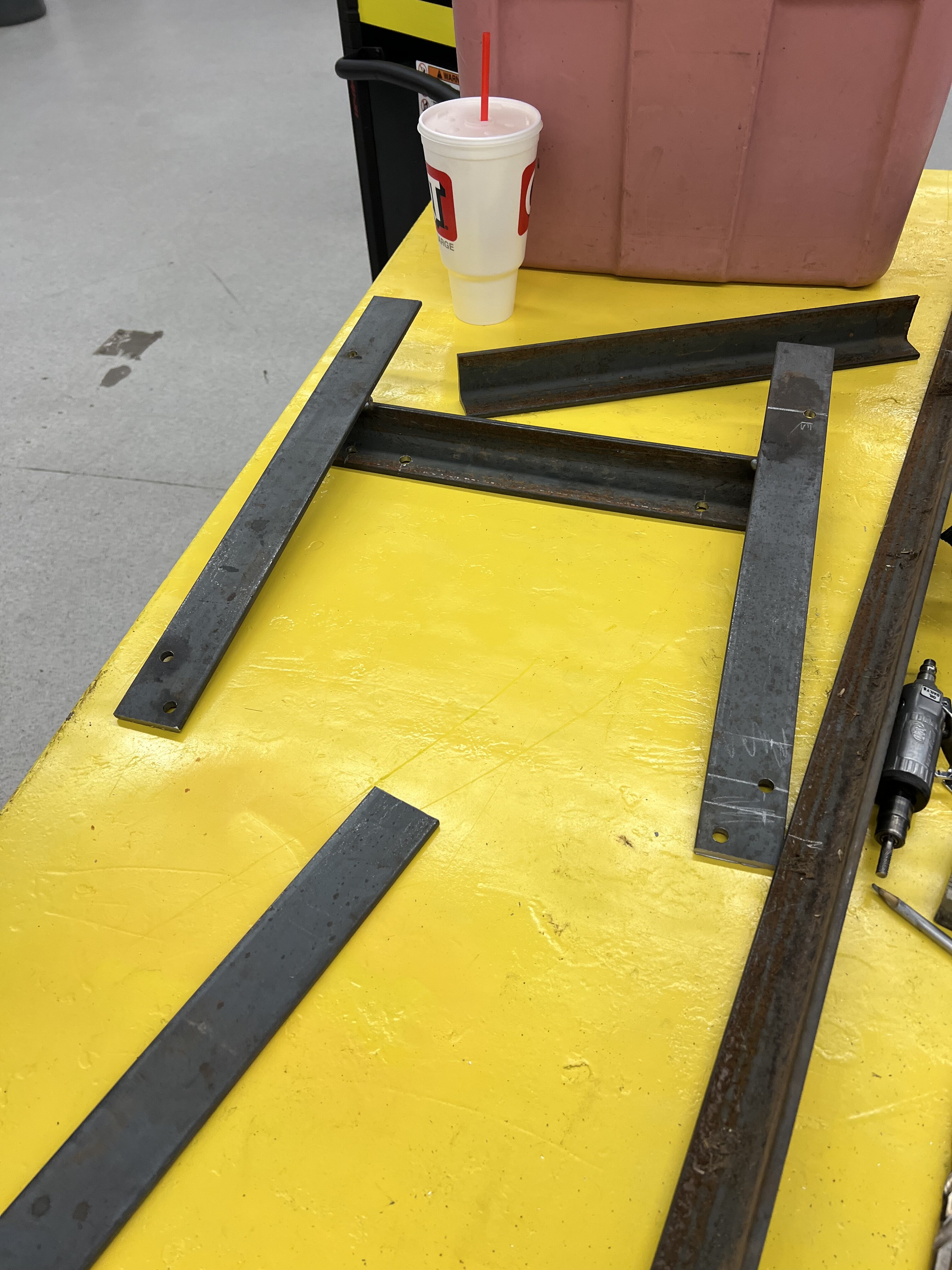

I welded together an adapter frame to bolt to my floor mounts so the new seats I used could bolt to to the adapter frame. I used 1/4 x 2” and some 2” angle.

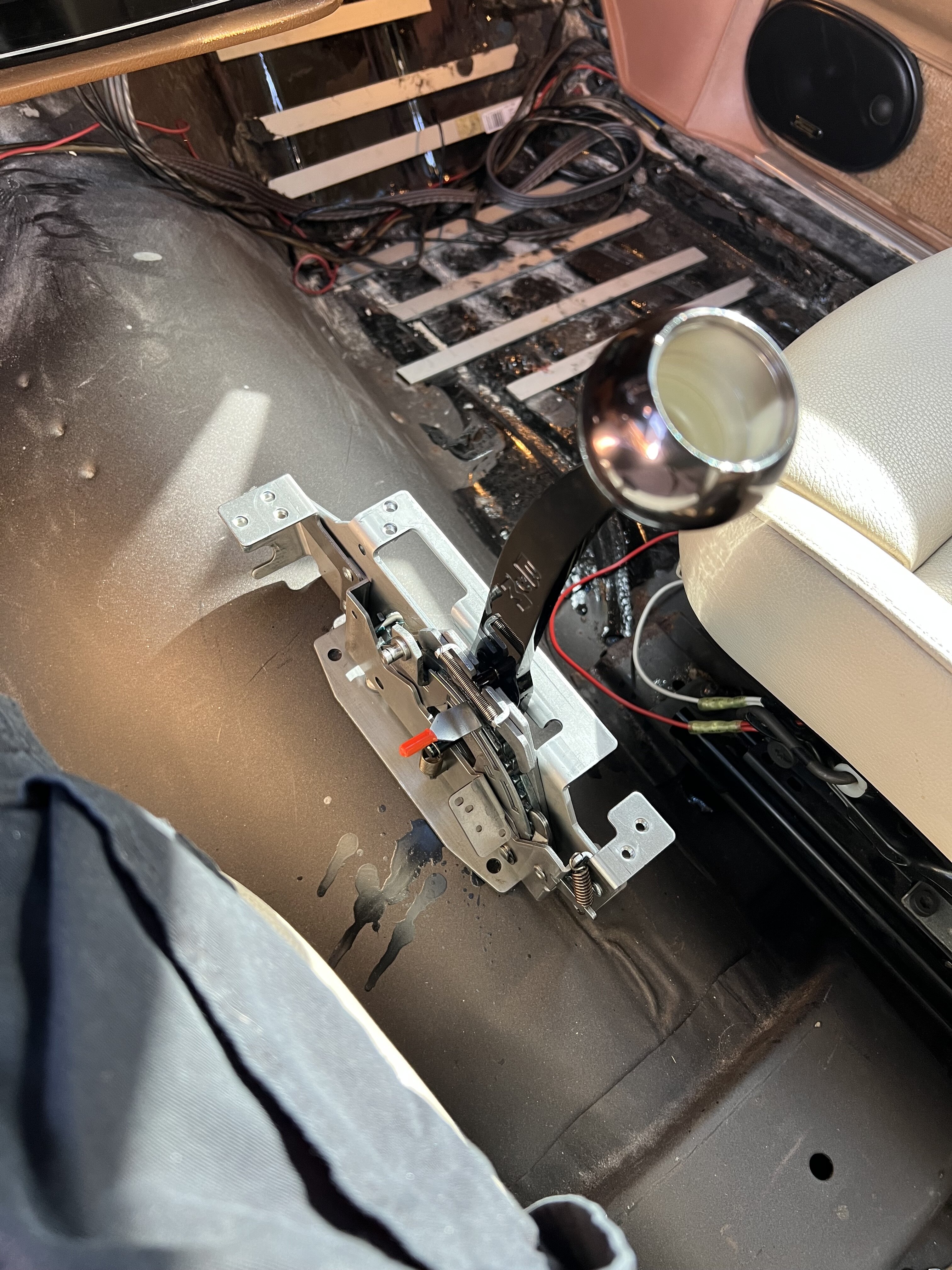

Then mounted my shifter where I wanted it.
