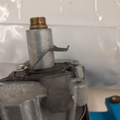

You actually have the culprit circled in your photo. Follow the speedometer cable into the speedometer head, there is a thin spring tab that you depress toward the speedometer to release the speedometer cable tube. Below is an example on a Monte Carlo speedometer but the Grand Prix should be the same.
Hope this helps!
