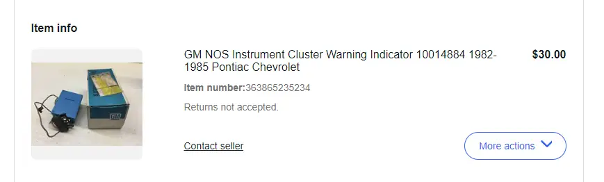

I bought a box months ago on eBay but didn't end up using it. I paid $30 for it and if you want it I'd sell it for that, because I fixed mine & don't need it. It was listed as NOS but I don't know if it works or not because I never put it in. I'd assume it does but can't say for sure.

I hate mine and want to remove it but I'm not too sure where it is and what it looks like. Does mine look like the above blue one? I can hear behind the gauge panel area. Can I just unplug it? And if so, you can have it if a 79 Malibu one will work.
That's a tough question. There are a few different styles. On the GP, it's right behind the headlamp switch. But I have read a few other articles here that the different models have it in different places. One of them being next to the radio on certain models. Thanks for the offer but I think it isn't compatible with my GP and I've decided to fix it according to Elcam's provided link. Looks easy enough to do. Hardest part will be finding a foam sheet that's about 1/5th of an inch. Thanks anyway.
