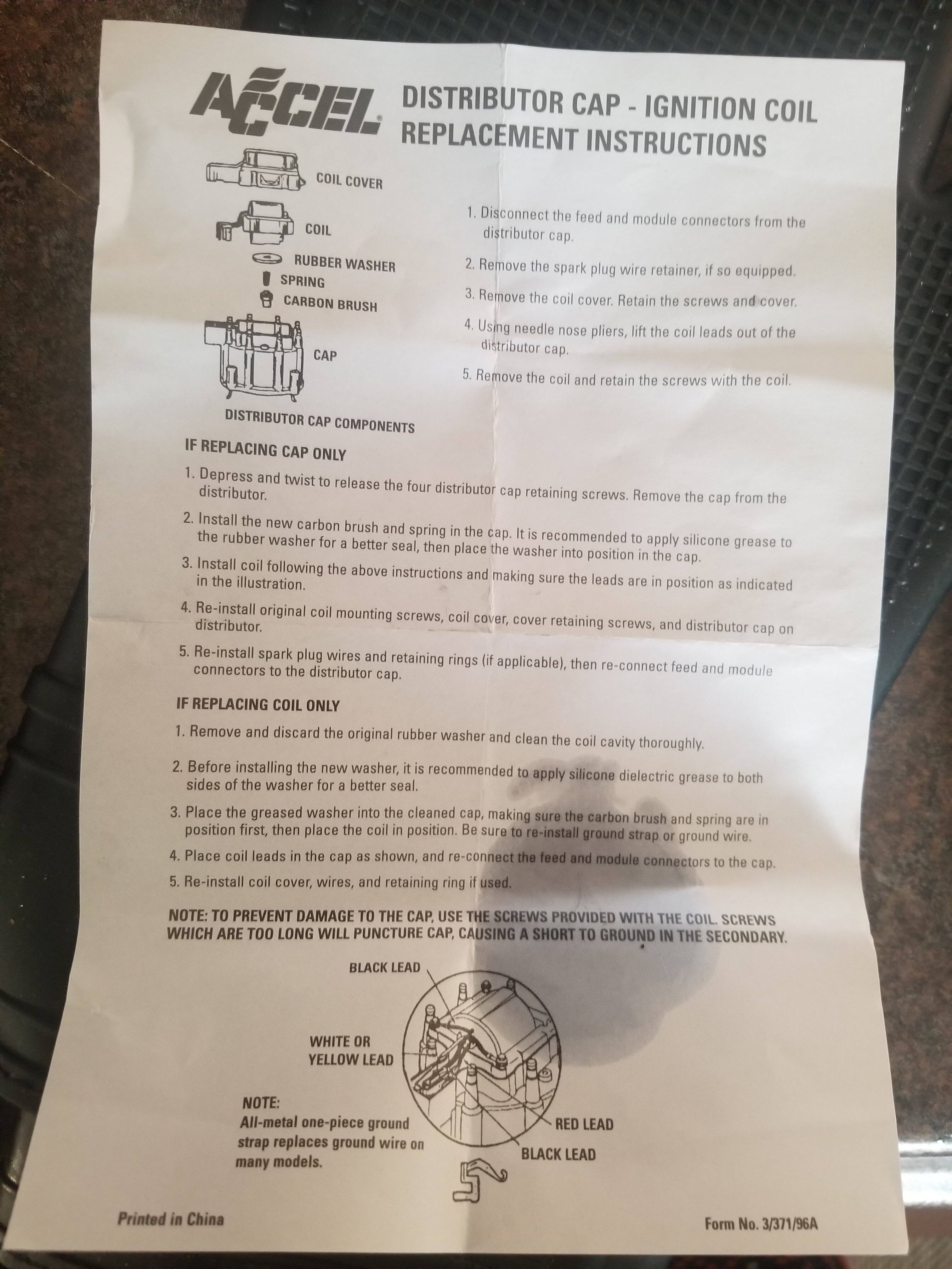

For sure but as said, those original parts rarely failed. I sure wouldn't be in a hurry to swap to the factory small cap. I am looking at owning a 88 to 95 truck, if it develops a miss, I know what to check first. We have a lot of gravel roads, maybe the vent plugs? Those trucks always got the Blue Streak Premium cap and rotors. I just assembled a cap in coil HEI yesterday. The Accel tan cap and rotor had instructions with a picture, which mentioned the contact goes in first then the gasket. It also came with dielectric grease. I used a MSD low ohm contact and there gasket, which is black vs Accel's orange. I used the Accel Brute Thunder coil which includes a tan dust cover, so it looks stock.View attachment 196800

Thanks everyone for the help. It was that the carbon spring were installed out of order. Shes back up and running great. I appreciate you guys.
