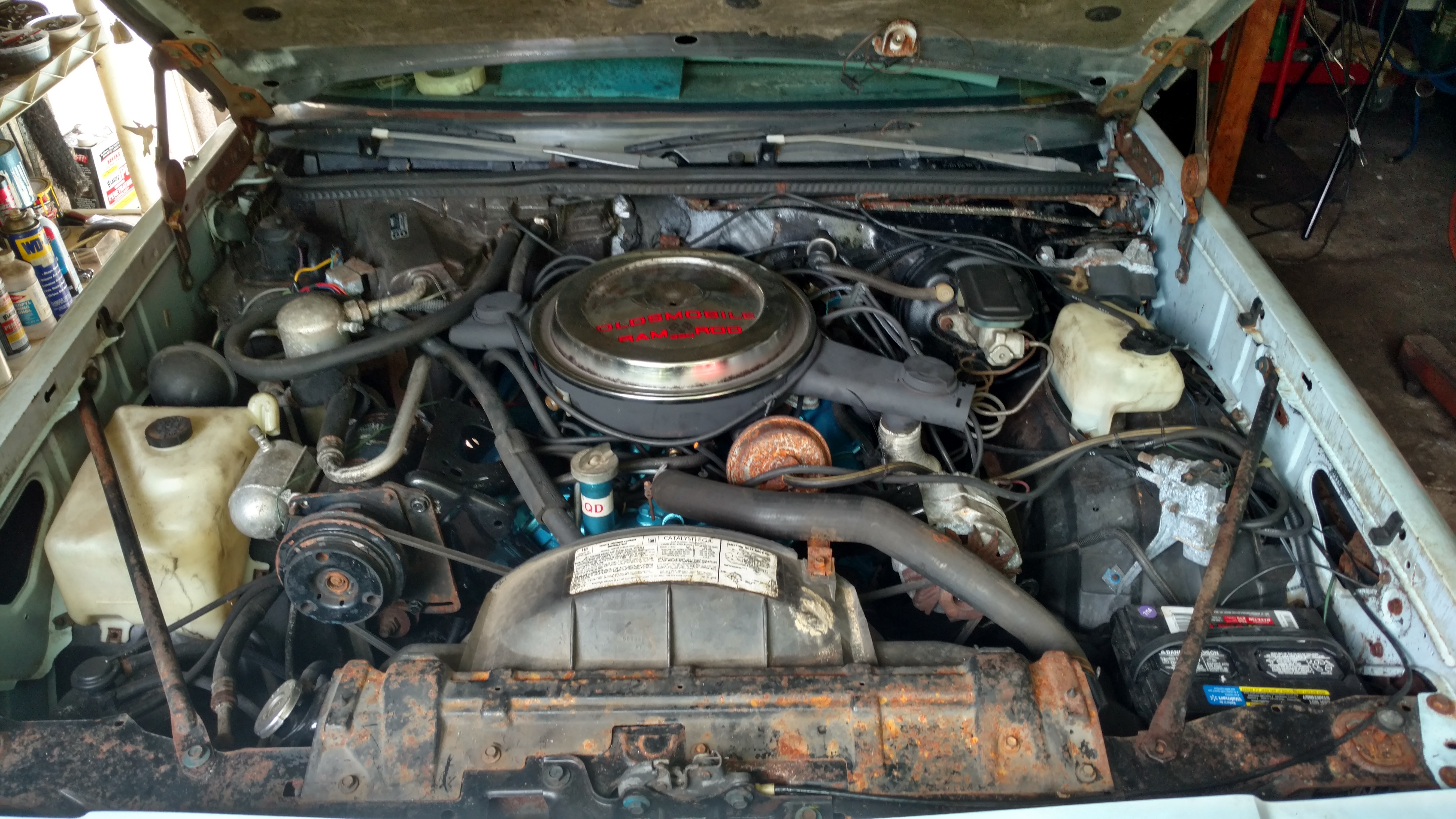

I ordered a iceman crossmember should be here any day now. Put the motor in today. The T/A and cutlass must have different alternator brackets that's the next thing to work out. Long day time to enjoy some beers
You will probably want the brackets and pullys from a 307 or 260 car
that's the 260 stuff in my 78 it puts the alternator off to the side way out of the way
Reactions: Paul Saulnier
The T/A has unique brackets for the 403. Looks like the A/C is gone. Olds actually moved the alternator to the passenger side where the A/C compressor sits. Hook up your PVC and use a real air cleaner at some point, of course I would have kept the factory 800 cfm Qjet any day over an Edelbrock carb as well.

Yeah I'll be throwing a different air cleaner on it before it's ready to be fired up. Going to get something low profile.
