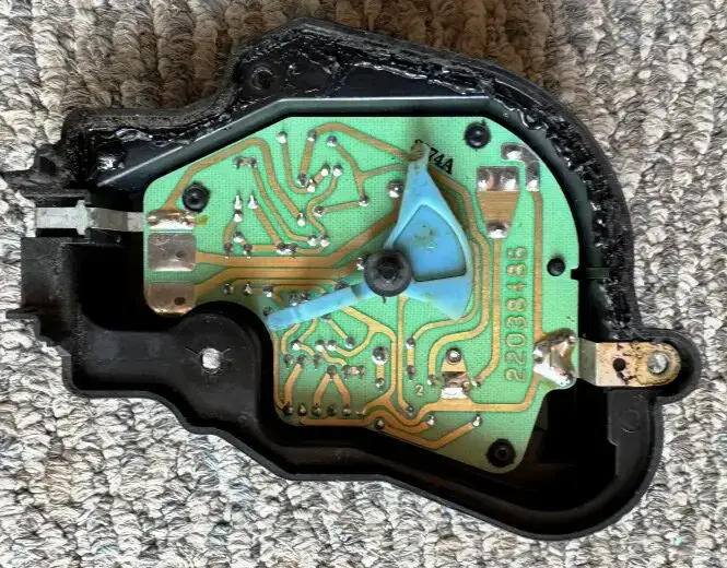

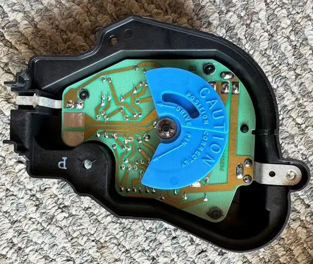

You got the 84-up style. It's the rotary type. These are controlled by the WSW circuit and if you have delay wipers, it's controlled by the motherboard inside the cover. Assuming you have delay wipers, did you install the cover properly with the blue wheel or pointer piece at the proper position?

And here's what you need to make sure of as far as the blue pointer or wheel- They should look like this position when installing on a PARKED WSW motor. Again, only if you have the Delay Wiper Option RPO CD4.
I appreciate the info. The only thing I replaced was the pump which didn't require taking anything apart. The pump simply pulls out of the bottom of the entire assembly. I didn't disassemble the parts in the pictures. Do I need to?
Sorry, my bad. I thought I read you had replaced the entire WSW motor, which usually don't come with a cover. Derp.
NO. You do not have to disassemble anything but that little clip on the cover that holds the pump in place. Just be careful not to break that slot area where the tab goes. Covers with the electronic guts are UNOBTANIUM.
