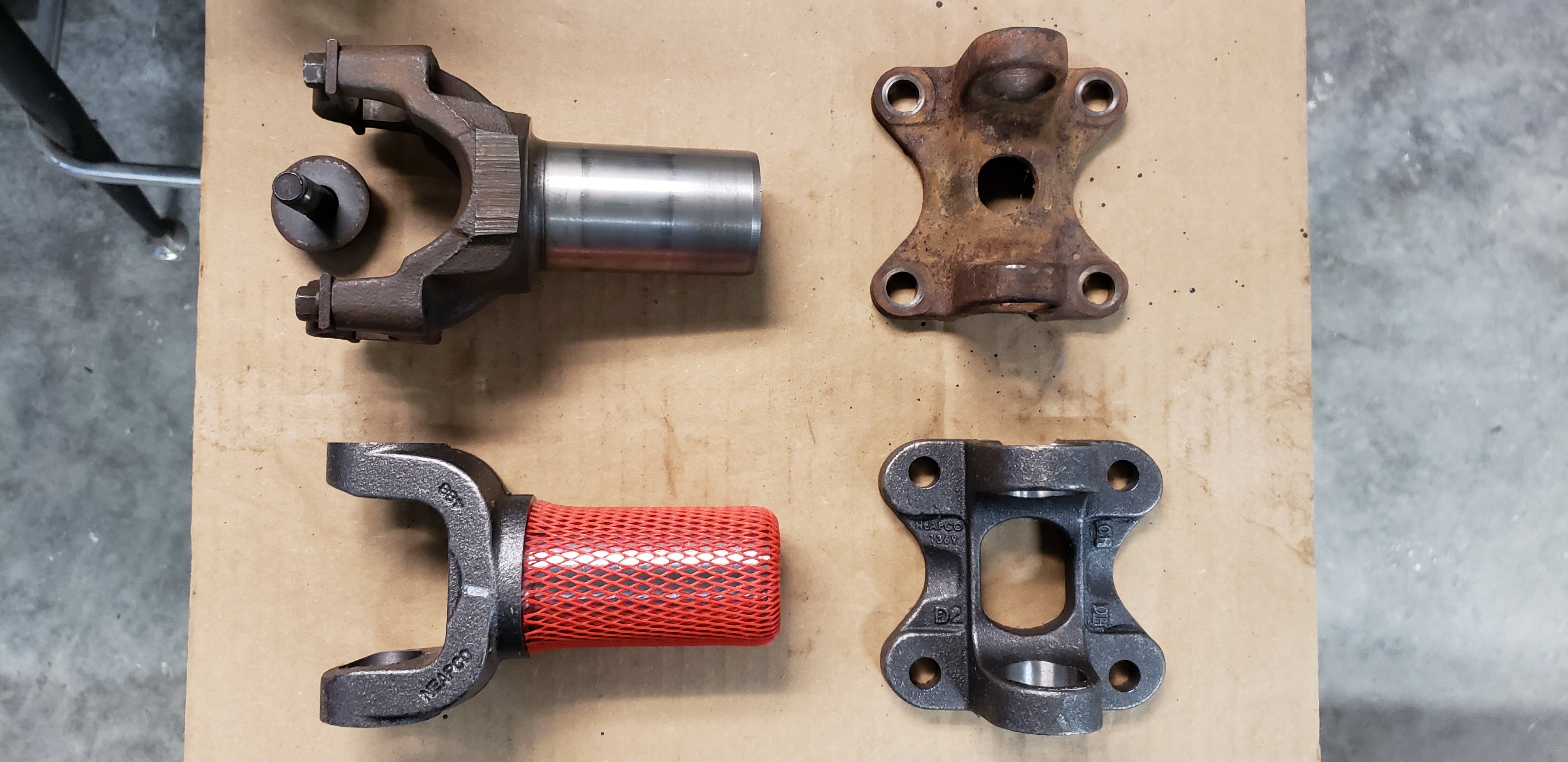

The TH400 came with the countebored "bolt on" yoke and I needed a slip yoke. After a bunch of research I settled on a Neapco N3-3-2431X TH400 Slip Yoke. It is a 32 spline, takes 1350 u-joints, and has the 0.530 counterbore to slide over the o-ring grove in the output shaft.
While I was on the driveline subject I picked up a Neapco N3-2-1579 flange yoke for the 8.8 rear end. The flange yoke that came with the rear end uses a 1330 u-joint and the Neapco uses a 1350.

Shouldn't the trans yoke extend further up the output shaft when converting to a slip yoke? I need to do the same to mine.

That's the one I need to get. Thought they were a little longer for some reason.
