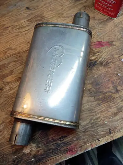

The Blackheart mufflers that came with my exhaust kit were too loud for me. I bought two different sets of thrush hush turbo style mufflers and went with the quietest. Here's a video of all three being tested with hooker iron exhaust manifolds and a stock 5.3L.
The hooker Blackheart mufflers are stainless steel and only have about 1,000 miles on them. I'll sell them to you for a hundred bucks plus shipping.

So in the first part is with the hooker blackheart, the second is with the thrush 17696 and the last is the thrush 17634?

Yes, in that order, the mufflers as described in the video. Still have the17696 if you want to try them as well.
