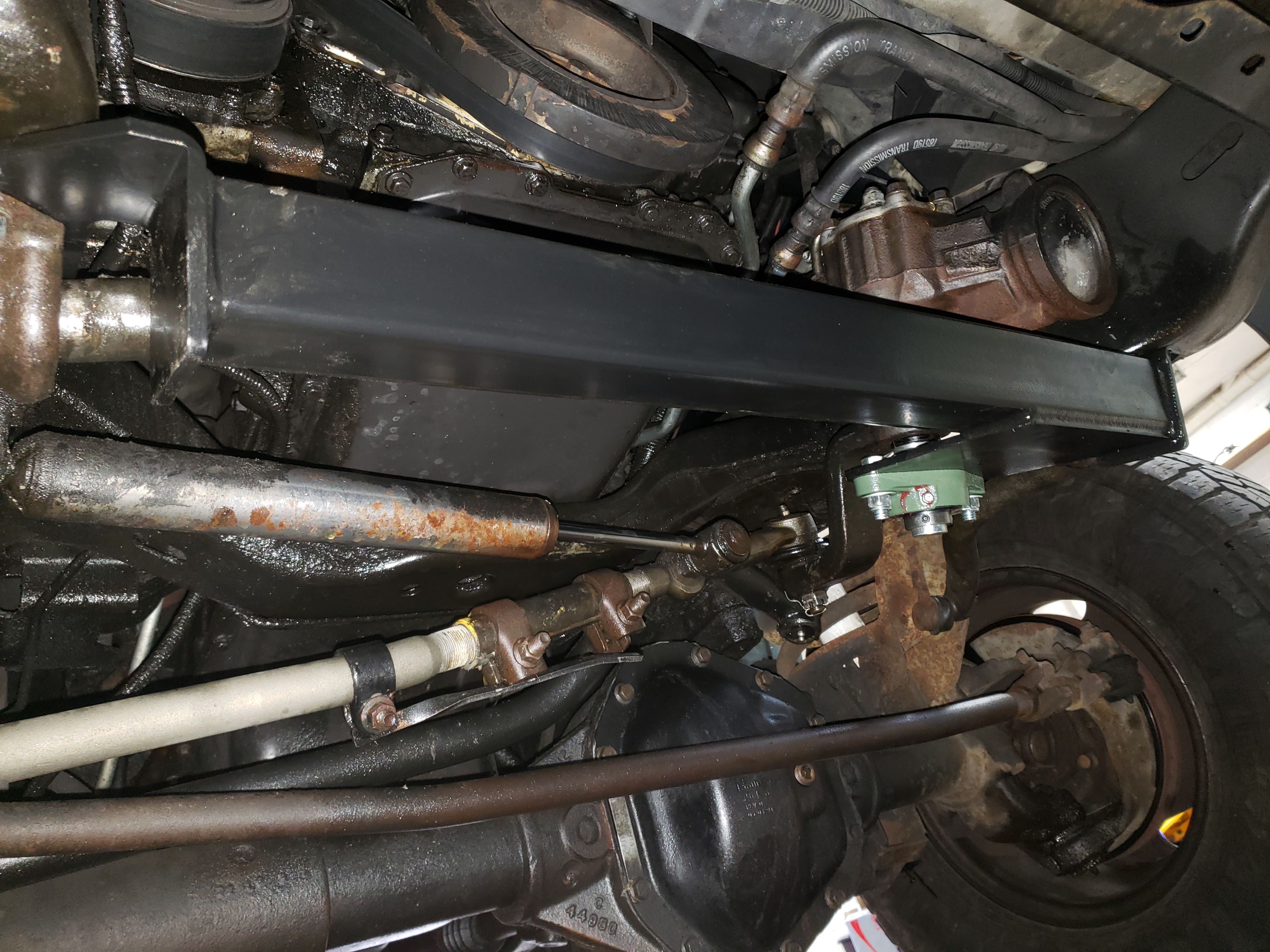

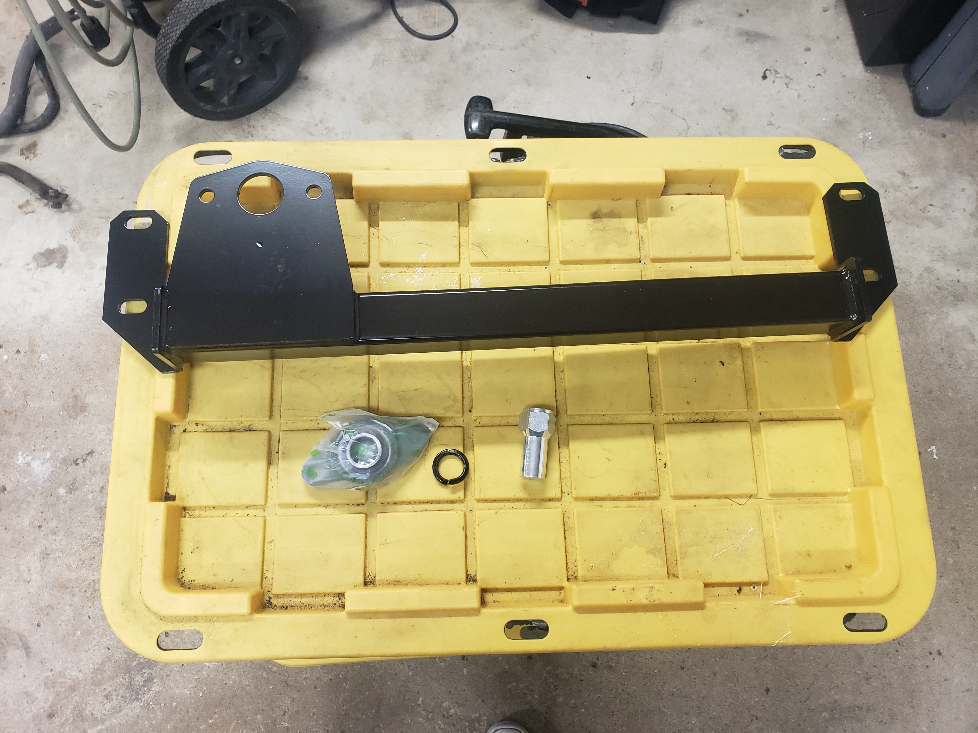

But for $40 shipped to my doorstep, I'm somewhat impressed. The bearing feels solid, I feared it might've been made out of pot metal but that isn't the case. It doesn't feel gritty at all. The brace itself is beefy. My other fear was that the metal might've been thin wall junk, but again not the case. The black finish appears to be powdercoat and not painted. They included hardware, the 4 sway bar bracket bolts were marked as class 10.9 and the 2 bolts for the bearing were marked as grade 5. Are they actually 10.9/grade 5? Who knows.
Install was about as simple as you'd expect. Everything fit well. I replaced the sway bar bushings while had it unbolted. The end links are shot too but I wasn't paying parts store prices for them so they'll have to wait until my next Rockauto order.
Does the steering feel any different? Not really. But I didn't expect it to either. I'm more interested in preventing the frame from flexing under low speed turns.

I used these to eliminate the joint that goes bad on the swaybar links. Allows you to use GM style replacements
No. It
slides up over the output shaft on the steering box then you put the pitman arm on and tighten the nut.
