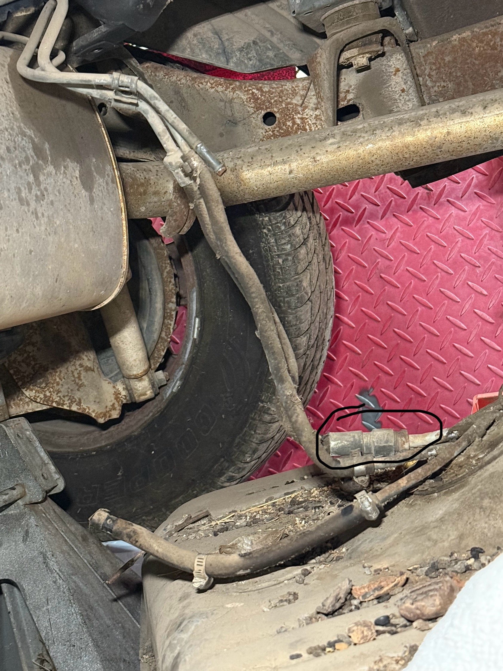

Need help! What line is this?

The line I circled was cut. It threads onto the sending unit versus clamped like the other two. Looks to be a type of rubber pressure hose that goes up to the curvy set on under the bed of the el camino. Can I just cut the threads off and clamp it? Or do I need to replace that whole line? Can’t find a replacement… any help would be appreciated!!!

That line end is crimped, indicates pressure. That line is larger indicates fuel outbound line. Smaller is return from pressure regulator. Other line looks to be vent/evap canister connection.
Was this originally a TBI engine? Supply line is usually 3/8 and return is 5/16. That's the common setup.

Is this a California emissions equipped Elky? Could be something specific to the California emissions for that year
