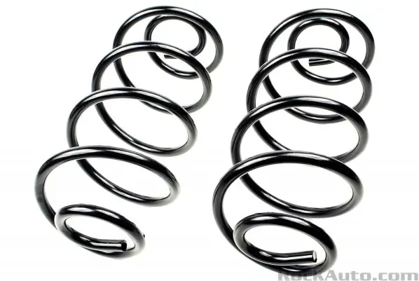

Did you receive the car with 'short' springs? Do you know anything about them? Rear springs on these cars can't be cut down as they have small coils at both ends. If they are short, then they are super-used up, or probably aftermarket lowering springs. These often have a higher spring rate (thicker wire) to reduce bottoming out when there is less suspension travel, plus better handling - so they will be much stiffer, and you lose that lovely GM 'waterbed' ride.
When you installed the spacers, how did you positively anchor the spacers to keep them from popping out under a road bump? 2 inches is quite the lift - did you do something similar to the front suspension? New springs are pretty cheap (shipping to CH, not so much) so you may want to try out a pair or set of stock replacements. I'd try that first before buying the Bilsteins - which you can add later to help manage the waterbed.

The springs are new stock replacements i bought about 2 years ago together with all other suspension parts when i had the frame removed.

The springs are new stock replacements i bought about 2 years ago when i had the frame off the body. I then replaced almost the whole suspension.
The problem startet only since i had the spacers installed and when i put the s10 shocks in. With the old gbody shoks it was fine, but on road bumps, the shocks bottomed out... thats why i put s10 shocks in to have enough movement in each direction.
Theres no problem with the spacers/springs popping out. I made them ca. 10mm / .4in to thick so theres allways a bit of pressure when fully extendet
