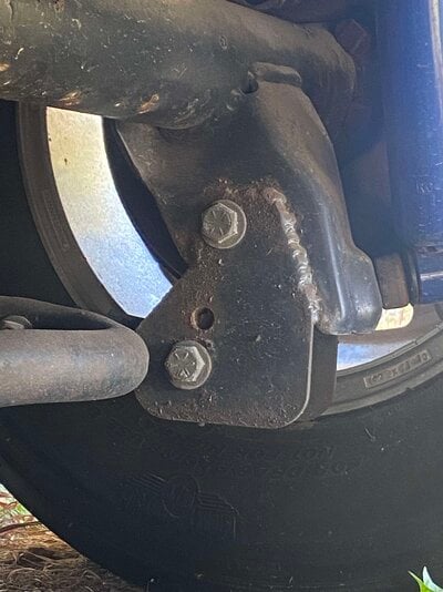

Looks like the rear lower control arms have been relocated:
