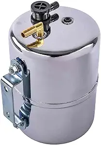

Assuming there are no actual issues with your braking system other than low vacuum, do you have a vacuum canister installed?
I have a similar set up in my Regal with a 355 SBC, stock front rotors with EBC pads and 11" Ford drums out back on my QP 9" and my Regal stops very well with having the reserve of the vacuum canister. They also come in black.
I dont have a canister. As far as a problem with the whole system, every single part is new. Front to back. Needless to say I was shocked when I tried to power brake the car in my driveway and went across my lawn. Brakes didnt hold at all. Same with driving it down my block. Standing on the pedal and it barely stopped.
