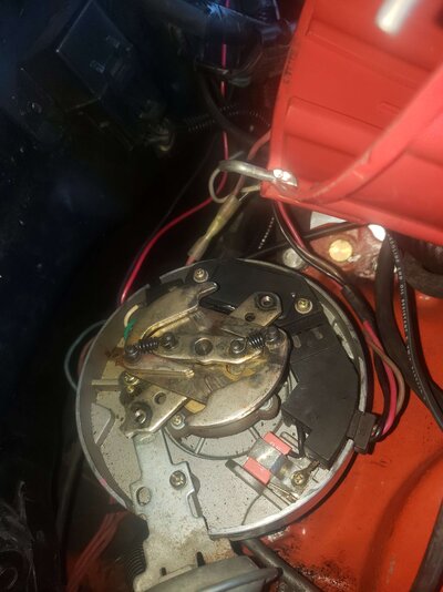

Ok my bad.... I thought you were still running the original 1984 HEI.
The above pic is of current HEI you are running now?
Is that how that plate looks in its non running state?
If you are running mechanical advance and bogging try the tune up kit lighter springs, heavier weights.
If your plate has the weights like they are in your photo out like that and not freely moving.. That is a major part of your problem. The weights have to move freely and spring back to center when the engine is not running.
If all that is good... Then have your module checked. It's very possible that It's high side is failing.
Also check your coil. As the coil goes bad the engine stumbles, misfires, bogs, poor acceleration, etc...

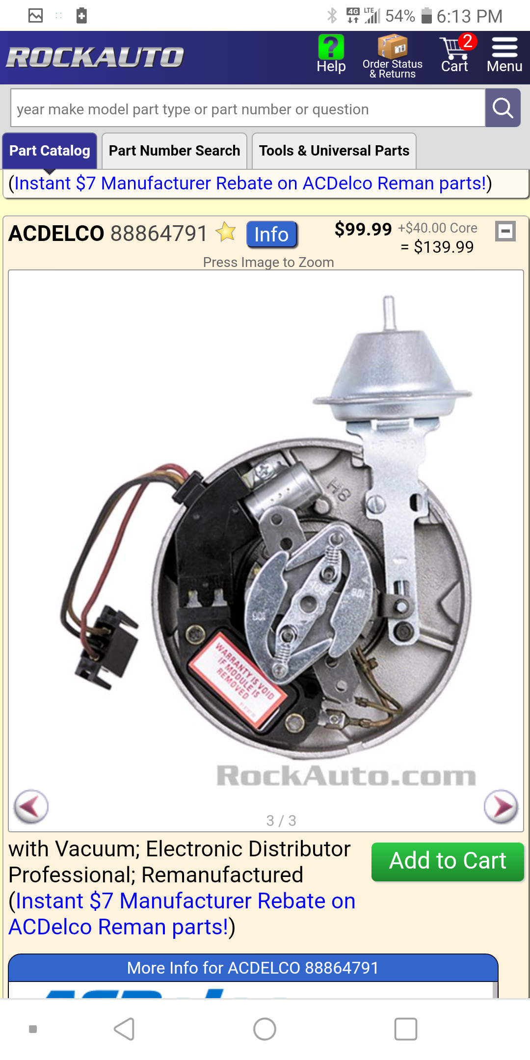

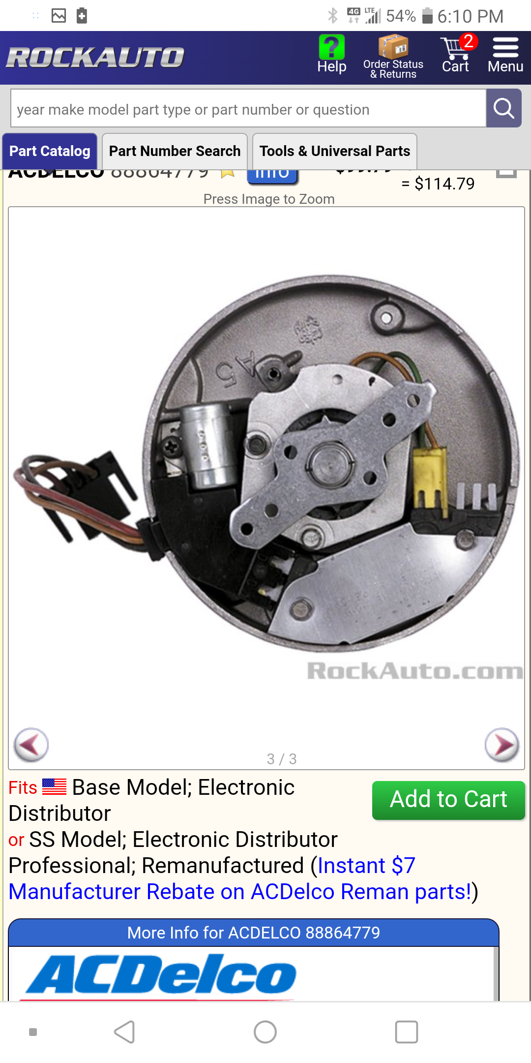

Just as reference:
Below is 1984 unit.... It has no advance.
Below is the 1974 to 1980 Pre-CCC/EST unit... It has Vacuum & Mechanical Advance.

Funny you mention that. So...I bought a weight and spring kit the other day. It was from Mr. Gasket. I put the lightest springs in, and changed the weights. Common sense told me the weights should move freely, which is why I got the kit. The new weights still seem to hang up. The "new" distributor I'm running is not brand new. It is used...just new to me. There are 2 "bumps" on the base plate that the weights hang up on. Friction is there. For all I know someone could have been messing with it, and put it upside down or something?
The bog is now worse with the lighter springs. I have a hunch that the weights aren't snapping back even more so with the light springs.
I suppose it's possible that both distributors were worn. 🤔

It could be that the previous owner of the distributor was trying a self made low dollar method of lock out.
Try to remove the weights and springs and see if you can repair or remove cause of the weights hanging up.

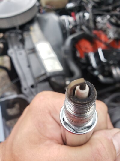

Pulled a plug to see what it looks like...
I'm no pro here. Not sure what I'm looking at.
