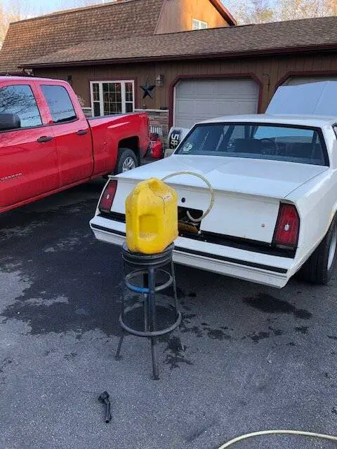

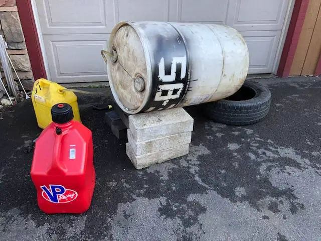

I swapped it over to E85 tonight and made a run of 30 miles round trip to get some fresh fuel. Driving it was gooooooood!
It appears that I'm waiting a couple of weekends to get it to the track unless I drive a long ways, which I don't want to do presently.
I know I have to come up with a better program to get the last 15 gallons out of the barrel lol
