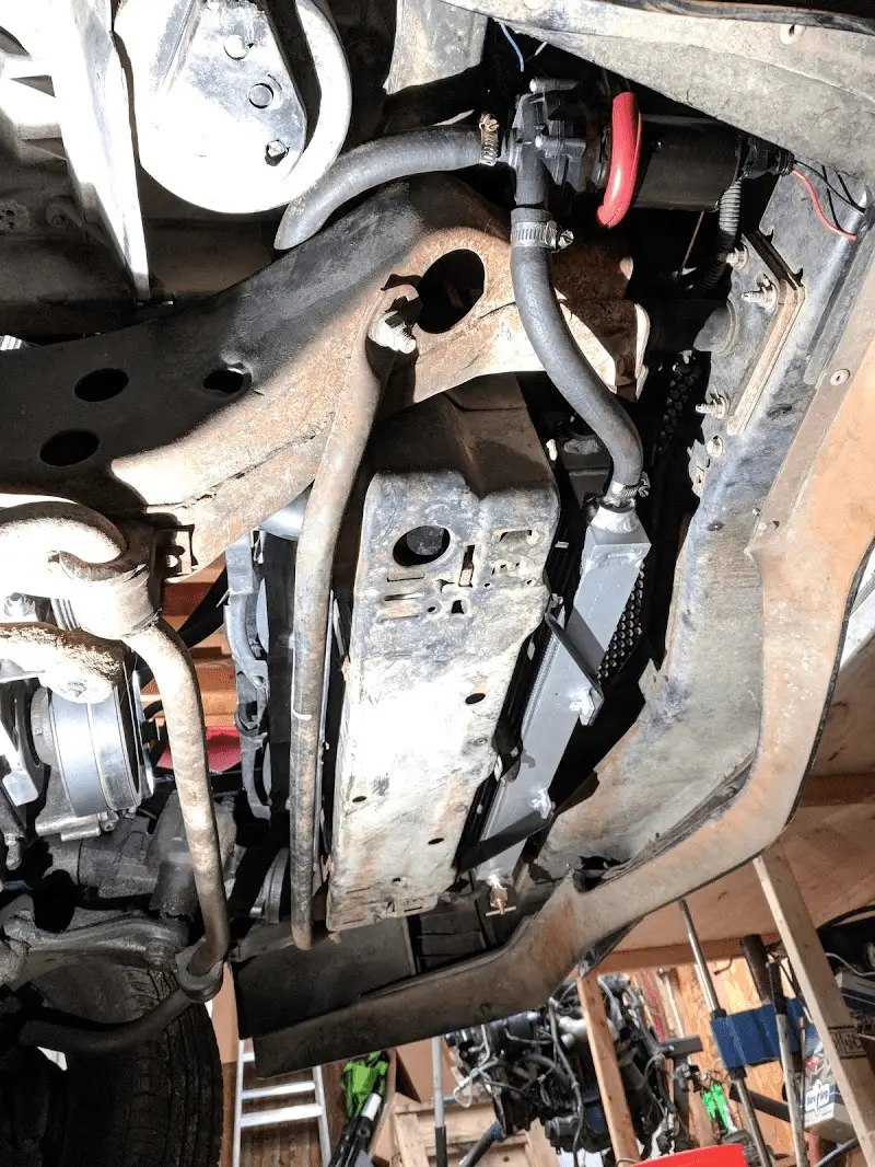

Yeah, those holes aren't helping. The MCSS airbox is designed to use air velocity from a high pressure area at the grill moving across the HXs and to the low pressure area behind the HXs. If I was going to make a suggestion it would be to seal up the stock ducting, divorce the intercooler from that area and lay it flat, put a scoop under the car to feed it (you can even make it adjustable for track vs street), and duct it to the low pressure area behind the core support. Isolate it from the heat source and give it a dedicated air stream. Its what I did with my TBSS. That will help both your IATs and any future demands on your cooling system from things like towing.

I'm concerned about the bolded sentence. I've thought that as a possibility. I can seal the holes easily, move the bottom of the cooler rearward and and put the chin spoiler on it. I'm n a quandry at the moment of what to do. Try using the factory grill opening, or blow holes in all of it and make more like a conventional (non-enduro bumper) G body front end. Be advised - I don't give a crap about cutting up the bumper cover, but it would be a shame if another option worked better or effectively.
Not sure yet. I've about talked myself into more radiator though lol. Probably order a Champion CC162 from Jegs today.
Thing is my MCSS (currently, may build one out of aluminum) has the air box deleted. But, I went hog wild sealing the crap out of the rad to the core support, I am running a lower air dam, and using a junkyard Ford fan and a homemade shroud.

Do you have or have access to a gopro or other camera you can stick under the nose while driving?
It would be awesome to tape some yarn between the bumper/grill and the core support and SEE where the air is flowing before you go crazy with cutting holes or adding ducting.

As far as the IAT issue, my HX is mounted in the same general place yours is but I am lucky enough that the GP has grates in the bumper directly in front of the HX. I thought about ducting but I have 5F water temp rise over ambient so I haven't put any more efforts into it.

The 2+2's never had ducting. Mine never had it and I saw a really low mile all original one also that didn't have any ducting.
