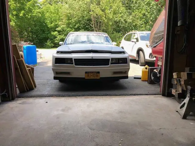

My intake temps were better, but still a runaway train. While contemplating the day's activities today I looked at the MC and it dawned on me that the radiator and intercooler are more than 3 times the size of the hole in the enduro bumper.
So I'm looking for some vents that are license plate size to put in the bumper on each side of the license plate. And I'm expecting to pull the black piece off from the bottom of the bumper and I'm going to fab a chin spoiler to install under the radiator much the way most of the other G-bodies are.
