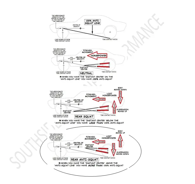

How low does the top plate need to be?
As low as possible. See Instant center photos.
