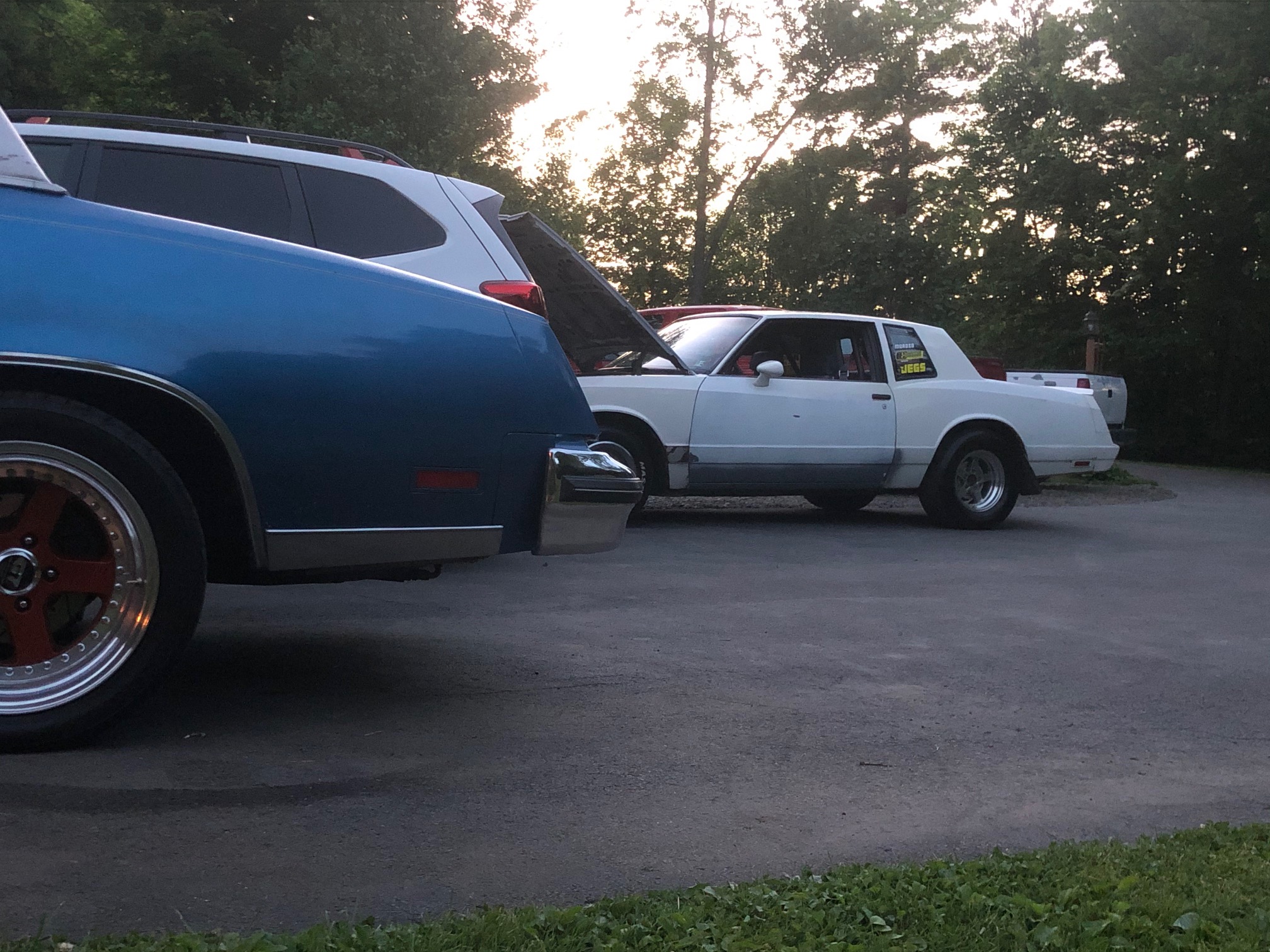

My son put the cleaning this old thing and put some tire shine on the wheels as well. Hopefully before drag Week hits I can convince him to throw a 50mph paint job on it. Keep in mind when looking at this pic that this has been in a dirt driveway for almost 15 years.

For the love of God, please lose the stickers on the quarter window.
I'm lmao. Someone else under the influence put them there as a joke. I told them that if we black out the window with stickers overlapping each other then maybe. But they would need to be 2-4 layers deep 🙂
