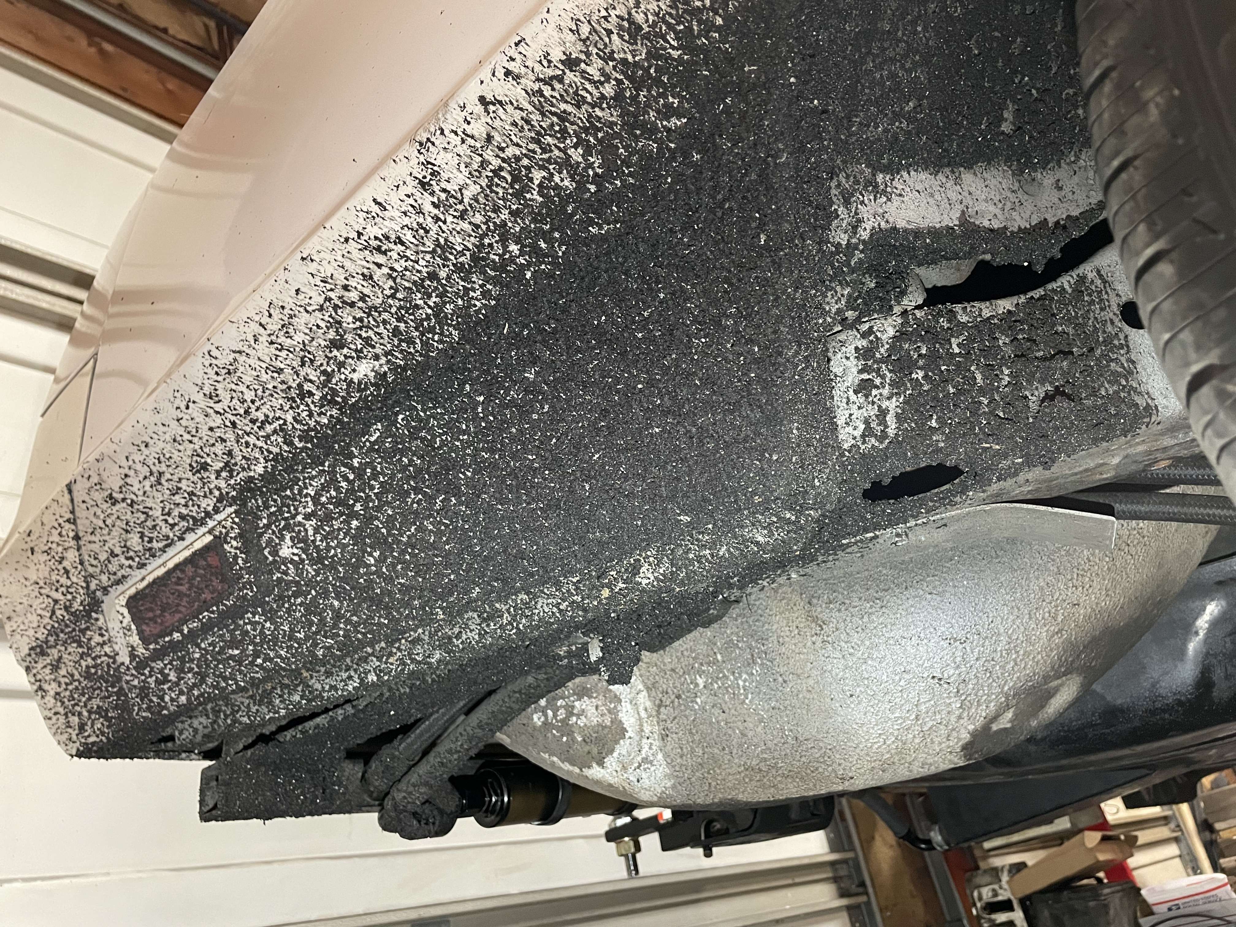

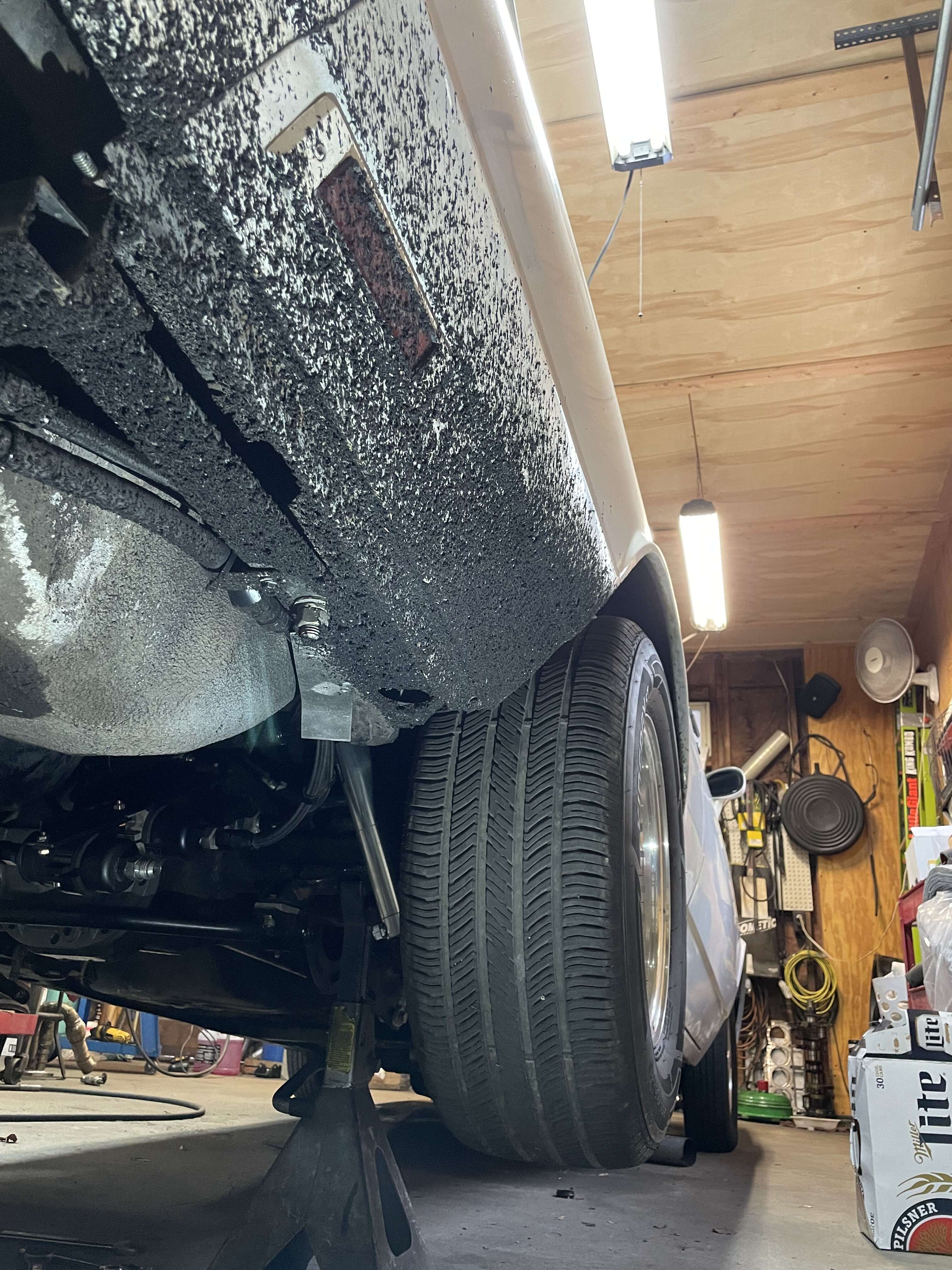

These aren’t pretty, but I put them in with the a-arms in the car. I should have tacked them in at ride height, then removed the arms and welded them ‘pretty’.
Wingnutks did his very well and I copied his setup. 1/2 x 4.5” full thread bolt through a nut welded in place of the factory bump stop.
22BD29D0-C5E3-4FDA-B4D9-FC319AFA7B42.jpegF7D67341-3E38-40FE-9AD3-BA0AD1293414.jpeg79F2AE07-334C-405D-9EC5-F5CFEA5221AF.jpeg
I forgot to loosen them up on the 3rd day and I never hit them driving. After that I left them alone. When I jack up the car in the crossmember the front wheels only drop 2.5-3”.
