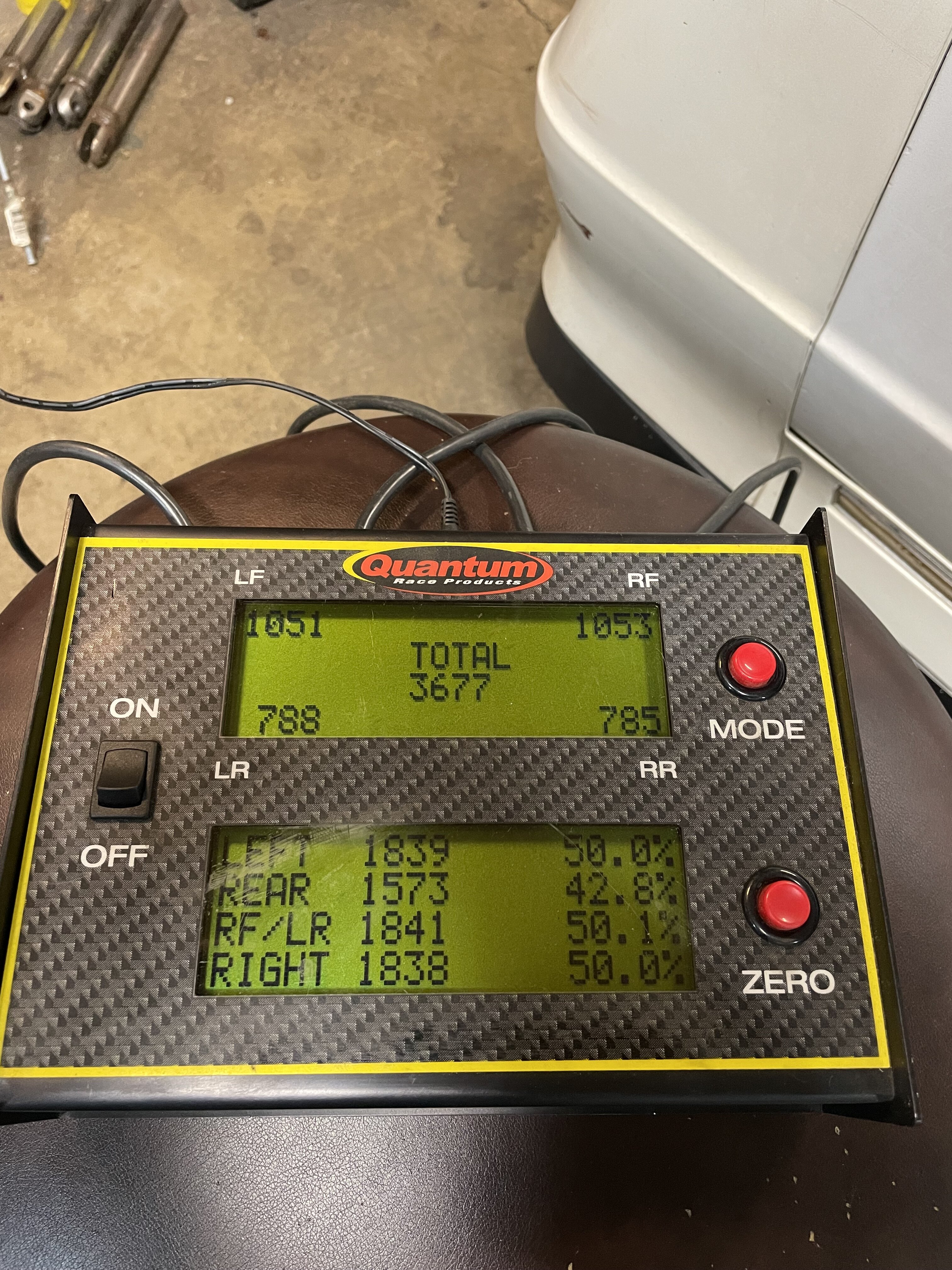

I should've mentioned that I'm considering a rack and pinion swap too for a couple of reasons - weight savings and engine pan. But I need to do a lot more research on what does and doesn't work with the swap.
Starting point of putting the car on a diet.
Iron 4.8, no coolant and 4 gallons of e85.
Hopefully 200+ lighter by spring and at least 150 off the front.
