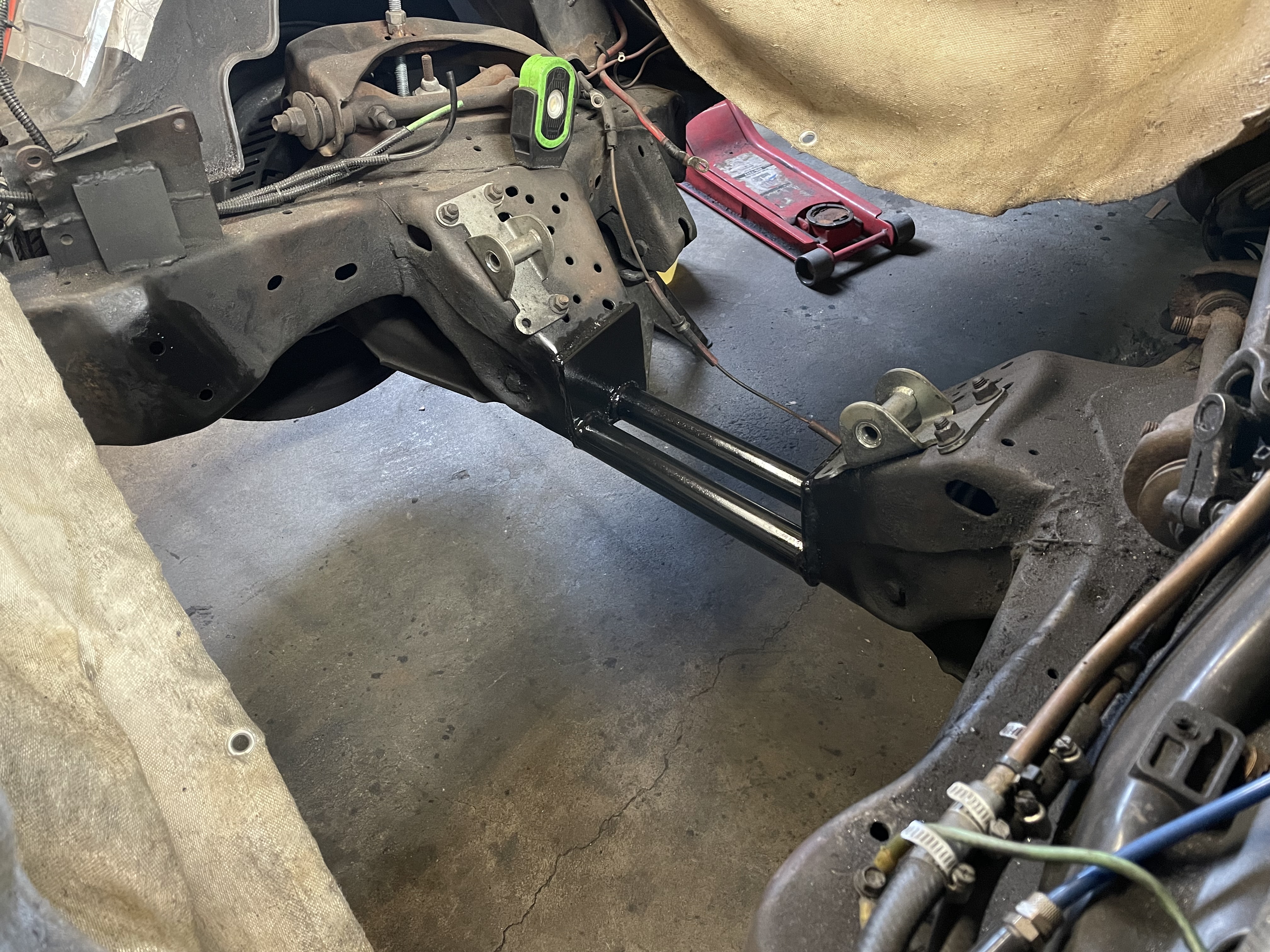

I’m I the processs of cutting out the front crossmember center area in an effort to make the oil pan removable without pulling the motor, and also make engine diaper install A TON easier.

I'm curious what you're envisioning for that front cross member? Obviously going to add some structure back in somehow.
I’ll have some photos before long. What I’m doing has been done many times that I’ve seen.
No,
Nice! Did you weigh the two tubes to compare?
I’ve seen plenty of people do that but usually put one tube back in.
No I didn't. But they are similar (within a lb or two).
