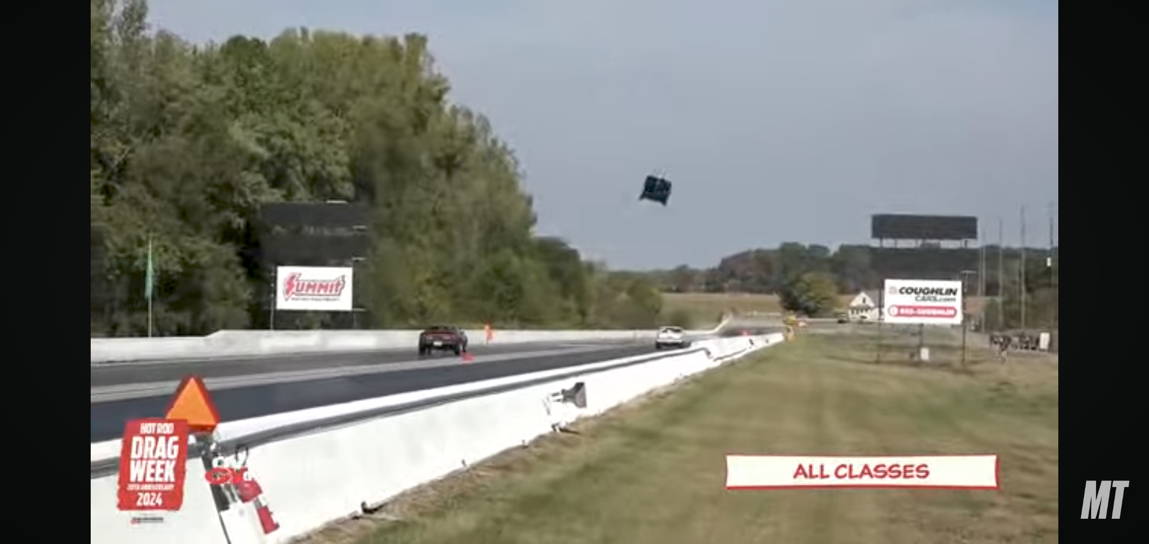

And some weight reduction through the traps...
Hopefully the hood can be repaired
You don’t need a hood for Drag Week!
The tracks were exceptionally prepped for radials all through the week. This was by far the best 60’ of the week. It actually hit timing cut for intake temps in the last .5 seconds of the run , hence the slow trap speed.
And fortunately, the hood is salvageable. The hood had been in Gelcoat since ‘21 until 3 weeks ago when my son painted it. Damn, can’t have nice things 😜
