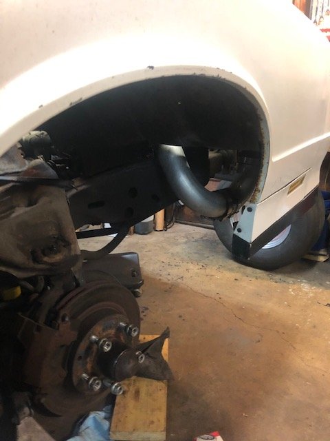

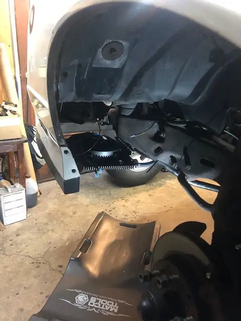

Still awaiting all of the transmission and related parts to return. But I could use some advice. From the factory, the area in front of the front tires below the inner fender was an unused space. But I have stuff there and it gets covered in road slime from the front tires. Any suggestions to cover these areas to protect them from front wheel road slime?
View attachment 153651View attachment 153652
