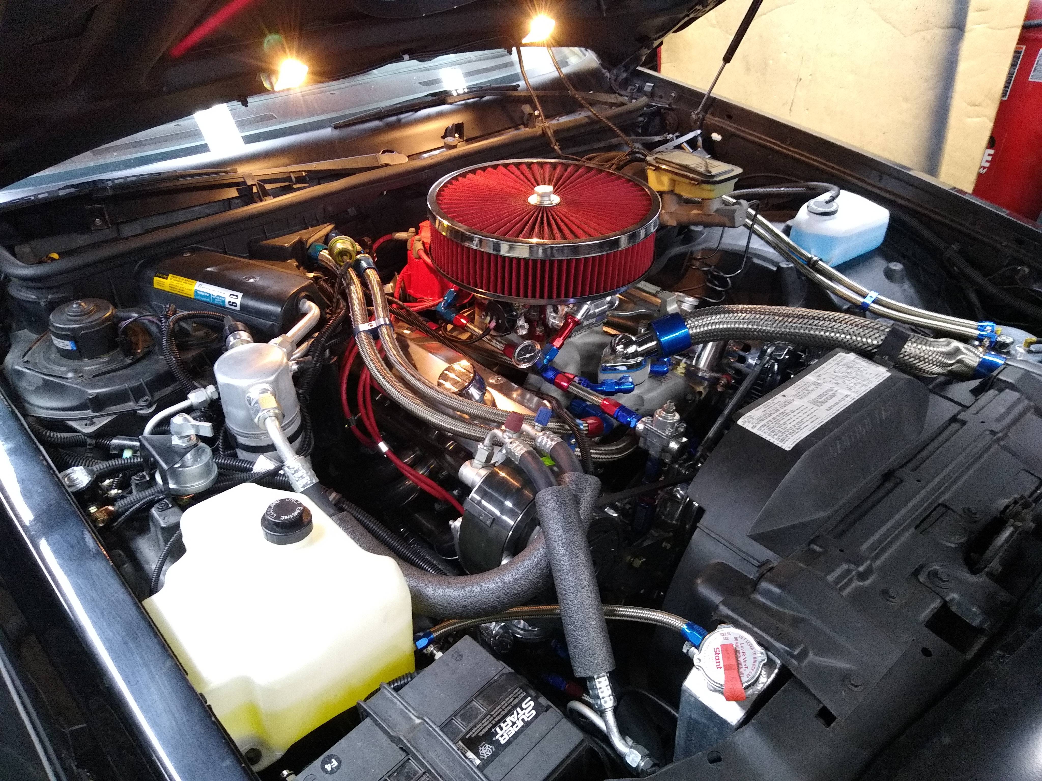

Factory style replacement on my Regal

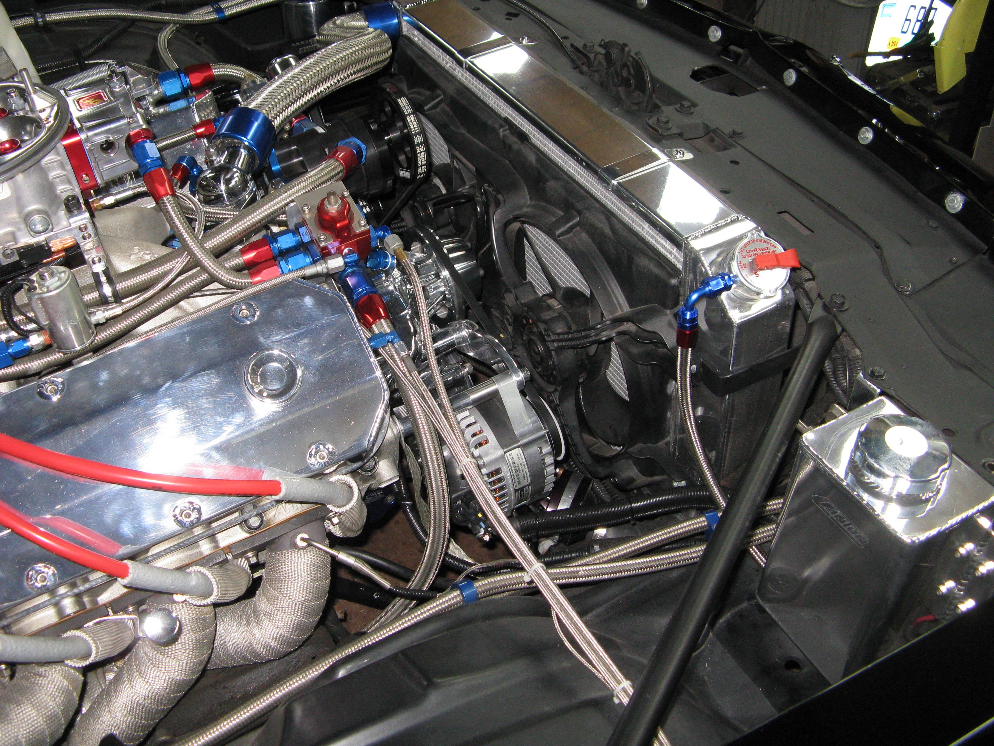

And a Canton recirculating 2 qt. aluminum can on my Monte

thank for photos. the tank on your regal is basically the same type container as the one on my cutlass with just the one hose . did the radiator caps your using come with the radiator when you purchase them or they just regular pressure relief cap for a factory radiator . When I call champion radiator they said I can only use a cap that's made for aluminum radiator which the local part store don't carry. and the only cap they have seems to be the same one that came with the radiator I purchased. by the way nice engine bay. I would like to suggest there be a engine bay of the month right.., I'm sure there are guys who put a lot of money, thought and work as you seem to have done to make their bay look like a work of art (like the regal ) good job ....... thanks again
I have always used Stant caps with the relief valve on all my aluminum radiators even the Champion that is in my Regal and I have never had any issues or ever bought a cap specifically for an aluminum radiator.
