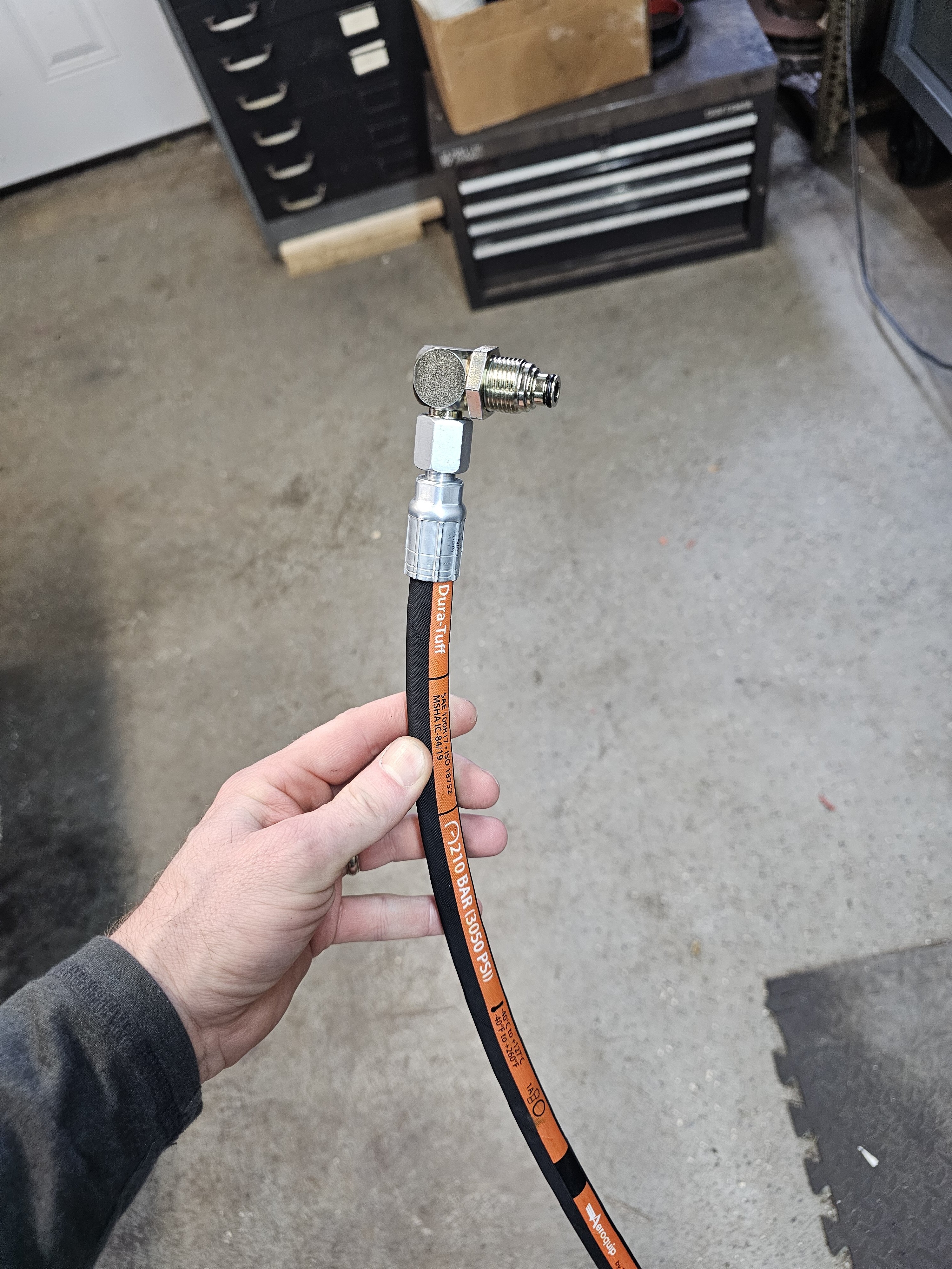

I had all sorts of issues with the power steering. Once I got the fitting from Lee Manufacturing I thought that was the hard part. After a quick internet search, Google showed that JIC and AN fittings were interchangeable. They in fact are not.
I had a local shape make a JIC hose and then found out it wouldn't fit.
So I tried a couple of fuel system AN fittings I had and they wouldn't fit. Figured they were probably just junk aftermarket cheapies. So I called Lee and asked what style end is on their fitting. I was told it was an AN end.
I ordered a ps line from ICT Billet. They had a generic 18" long ps line with AN ends. It didn't screw on. The threads on the Lee fitting were wrong, damaged, whatever.
Now this entire time I only used my fingers to try fittings on. As soon as they stopped threading on, I backed them off.
Called Lee, they said they hadn't seen anything before and they would ship another out. Good on them but I wanted to get this is up and running this weekend.
Took a file to the threads and finally just stuck it in a vise and cranked a fuel system AN fitting on it. It did go on, but you can also see what it did to the threads. Decided to just send it and install the new ICT hose and tighten it down. Hopefully it only needs to go on once LOL

Forget which is which one is 37° with is 45° then there's another for LP/NG stuff.
Depending on what you're trying to do yes they can interchange.
FWIW You are pushing ~1000psi with the PS steering system
JIC and AN are both 37°. Yes I know about the pressure. The line I used from ICT and the JIC line I had made are both rated for more than that pressure
