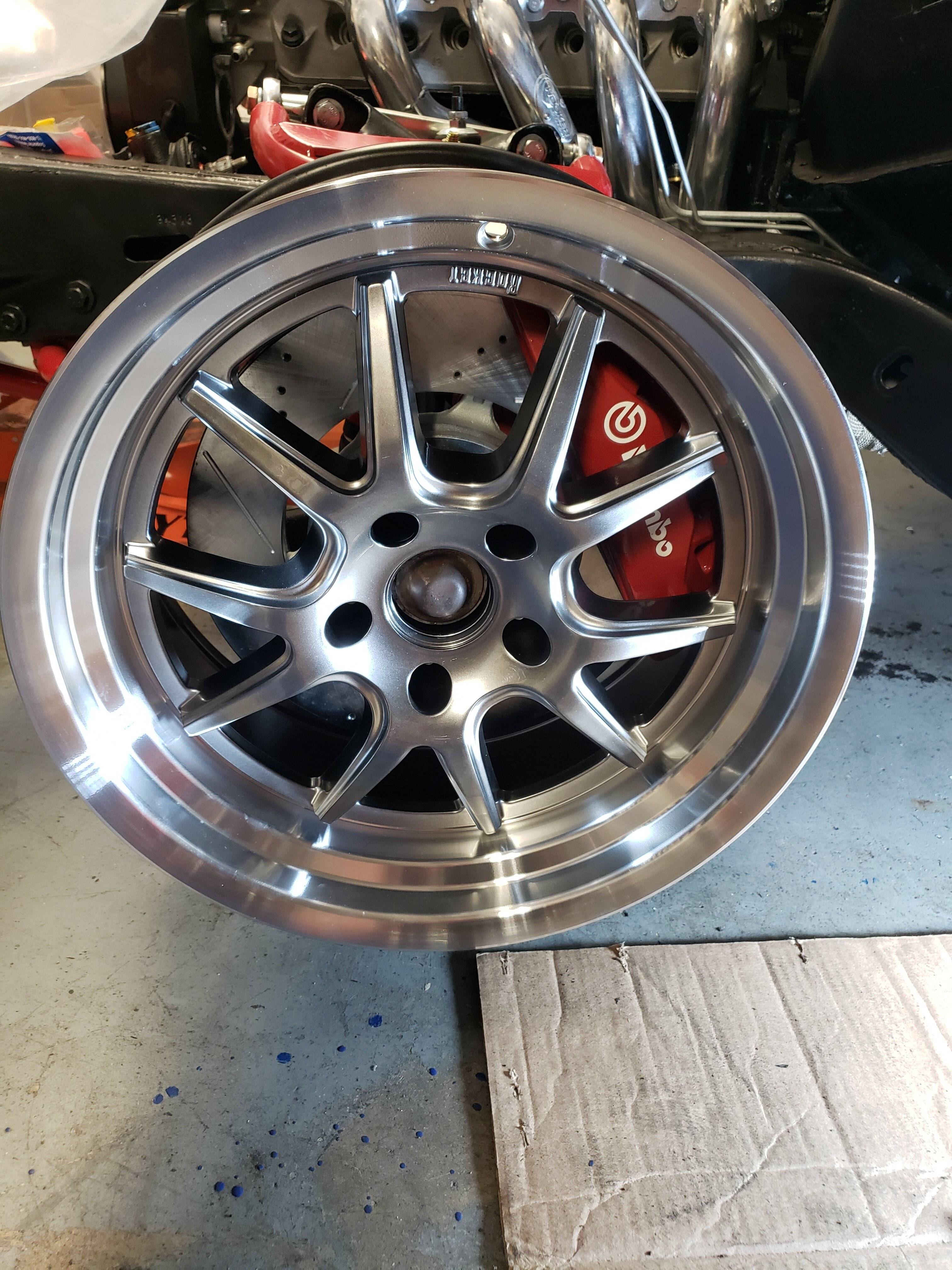

The plan is C6 Z06 front six piston calipers, 14" front rotors, and LS1 rear disc's. Found the rear brake backing plate assemblies. Those are on their way currently. Still haven't heard anything from Kore3 yet about the front brackets and calipers. Little nervous about the front fitment. Car isn't currently at my house. I store it at my parents a few miles away for the winter. Hoping they fit inside my 18" wheels. 🤞

Shawn, I was under the impression that the Z06 fronts would fit in a 17" wheel. I'm sure they'll fit your 18's unless you have a strangely designed wheel.
From what I've been reading, most 18" wheels fit, but some don't... mine are just cast, not forged, so I know they are thicker... time will tell.

There is a very good likelihood you are gonna have to space your wheel out to clear those big boys, thats what I had to do with my 20s. I have been debating on buying some forged wheels for it over the winter but want to focus on finishing up the blazer and get the Monte running more consistent before worrying about wheels
