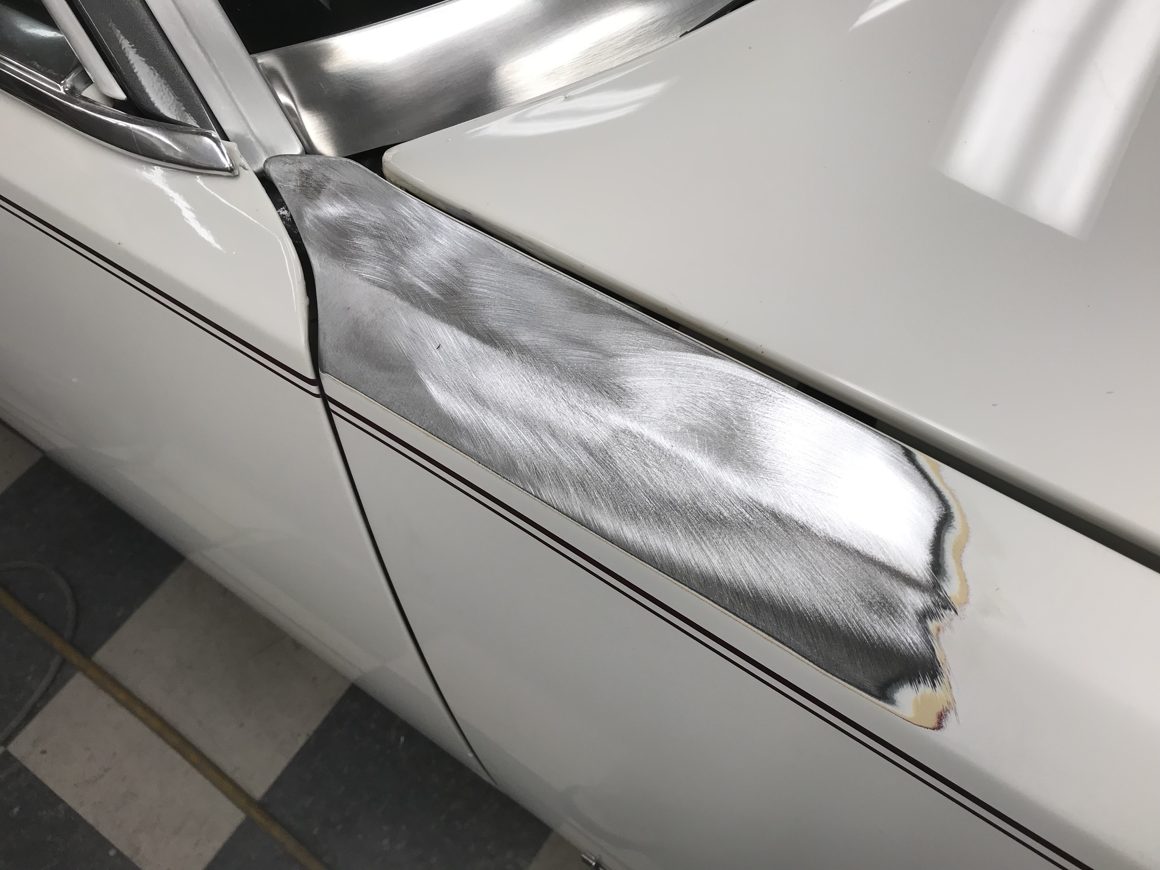

Starting with giving the top of the passenger side fender a good cleaning with wax and grease remover, I started preparing the area to get the unneeded antenna hole welded up. Once the area was down to clean bare metal, I cut out a patch for it with a hole saw and laid the patch over the irregularly cut hole. (Someone had added an aftermarket antenna at some point and butchered the hole in the fender)
With the patch overlaid, I traced around it and opened up the hole to a uniform size, then started tacking it in:
A little fine tuning and tweaking as I went, I got it fully burned in. I took the opportunity to remove the silly little fender trim piece too as it won’t be going back on, and buzzed up the hole for that too.
Once it was all ground flush, it was metal finished in 40 grit and is now ready for a skim of filler:
It ain’t much yet, but it’s a start. From here I’ll probably go onto skimming and blocking it out, and then maybe onto the lower part of the same fender as it’s got a few damage issues from a previous owner.
