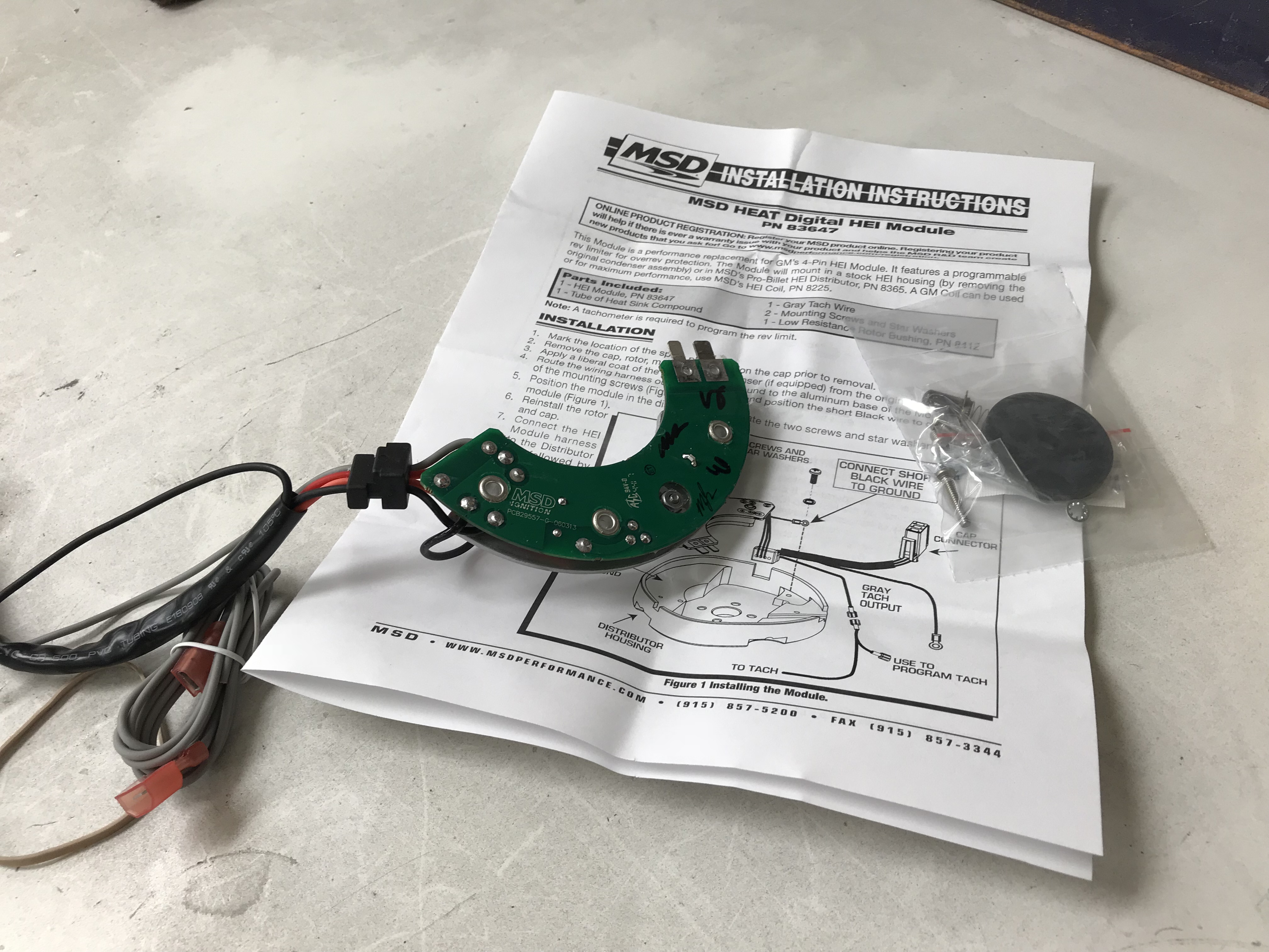

I found a quick couple minutes to stop in at the speed shop during my day, got the starter exchanged for the correct one, grabbed some ZDDP additive to go with the forgotten oil, picked up an MSD digital HEI module, and inquired about the Edelbrock jets and secondary rods for the QJ.
Unfortunately they didn’t have either in stock, but I paid for them up front and they should be here in roughly 2-3 weeks direct from Edelbrock.

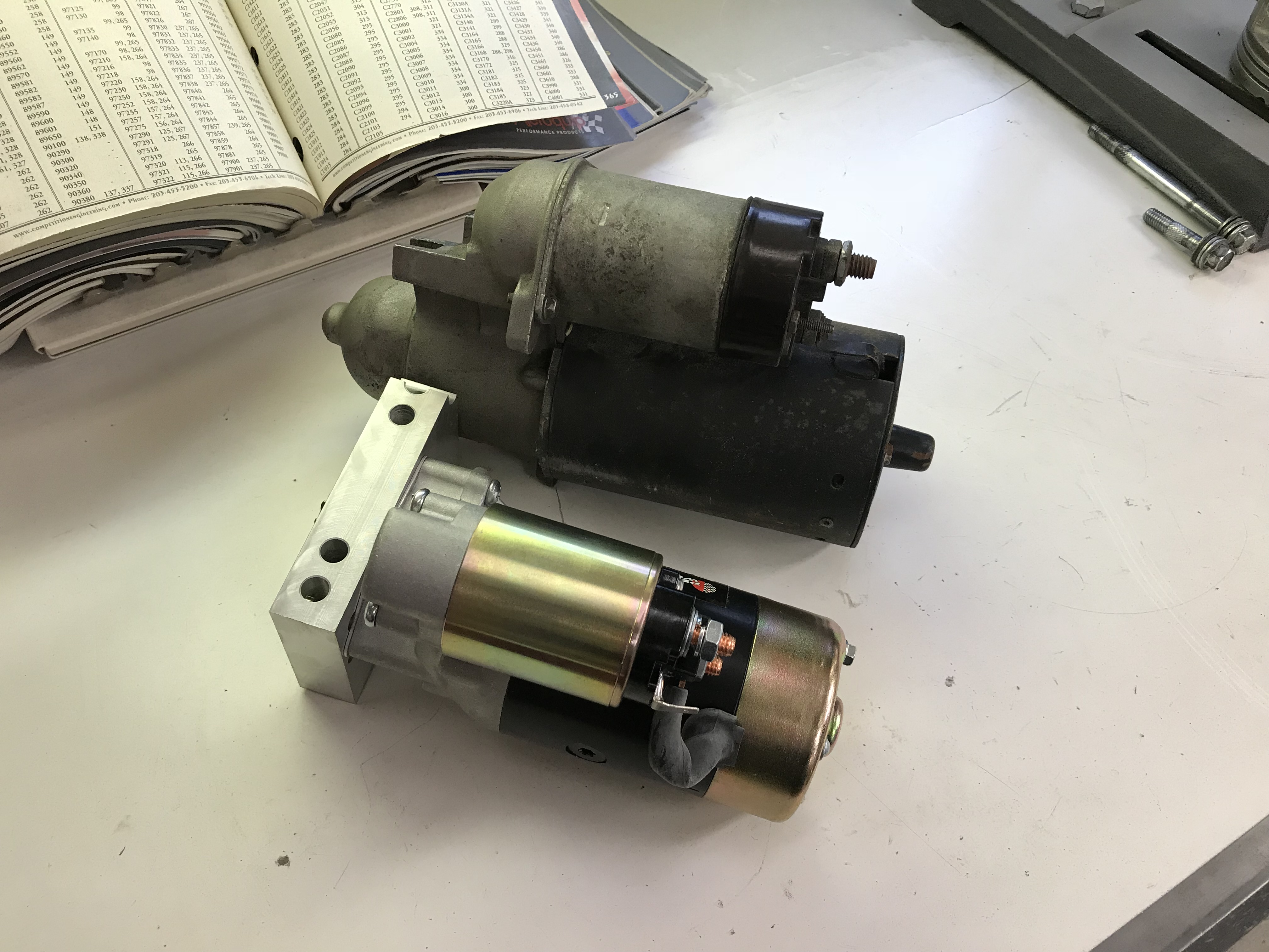

Once home, I immediately test fit the new starter (shown here alongside the old one)...
...and was pleased to see it was finally the correct one. After double checking the ring gear engagement and the clearances I torqued it to spec, bolted the exhaust and inspection cover back up and moved onto completing the oil change.
In my haste yesterday I made the rookie mistake of forgetting to prime the oil filter, so that was the first thing I looked after. I mixed in the ZDDP additive as I was adding the oil, so all should be good there as well.
Once things were buttoned back up, I fired up the car and let her get up to temp. I’m pleased to report the new starter sounds and works beautifully. It has no problems whatsoever spinning over this mill even with the aggressive initial timing I’ve got into it.

I plumb ran outta time tonight, but tomorrow I plan on installing the digital HEI module...
