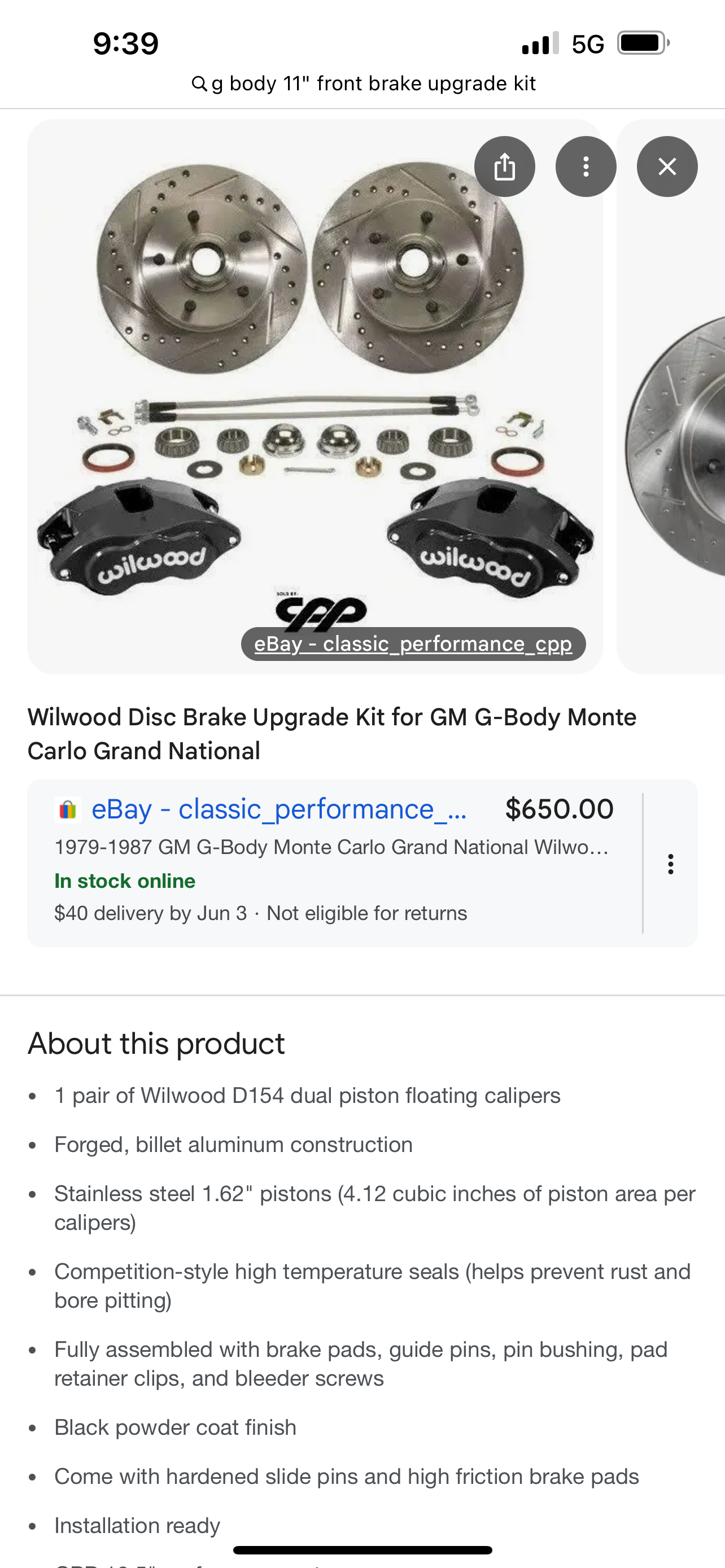

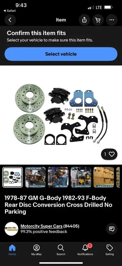

I have tried both ports on the master cylinder I have willwood 2 piston calipers with stock size slotted vented rotors on front with 15” wheels on 245/60/15 tires. I am starting to think that the master is bad and will have a new one today
These are the ones I used

I think you found out how bad the front is even slightly upgraded.
If everything is working as designed/capacity.. you'll most likely need to install a adjustable base valve to reduce rear brakes.
Could get more aggressive pad compound for the front...to give you more bite.
Supercharged111 D154 calipers are an upgrade over stock
Generally a 11" rear DISC needs 12" disc in the front
D154 in and of itself could mean more than 1 thing. For example:
If the stock caliper piston was 2.5" then a stock piston has an area of 4.9 sq/in. OP replaced that with calipers with an area of 4.12 sq/in and thus downgraded.
