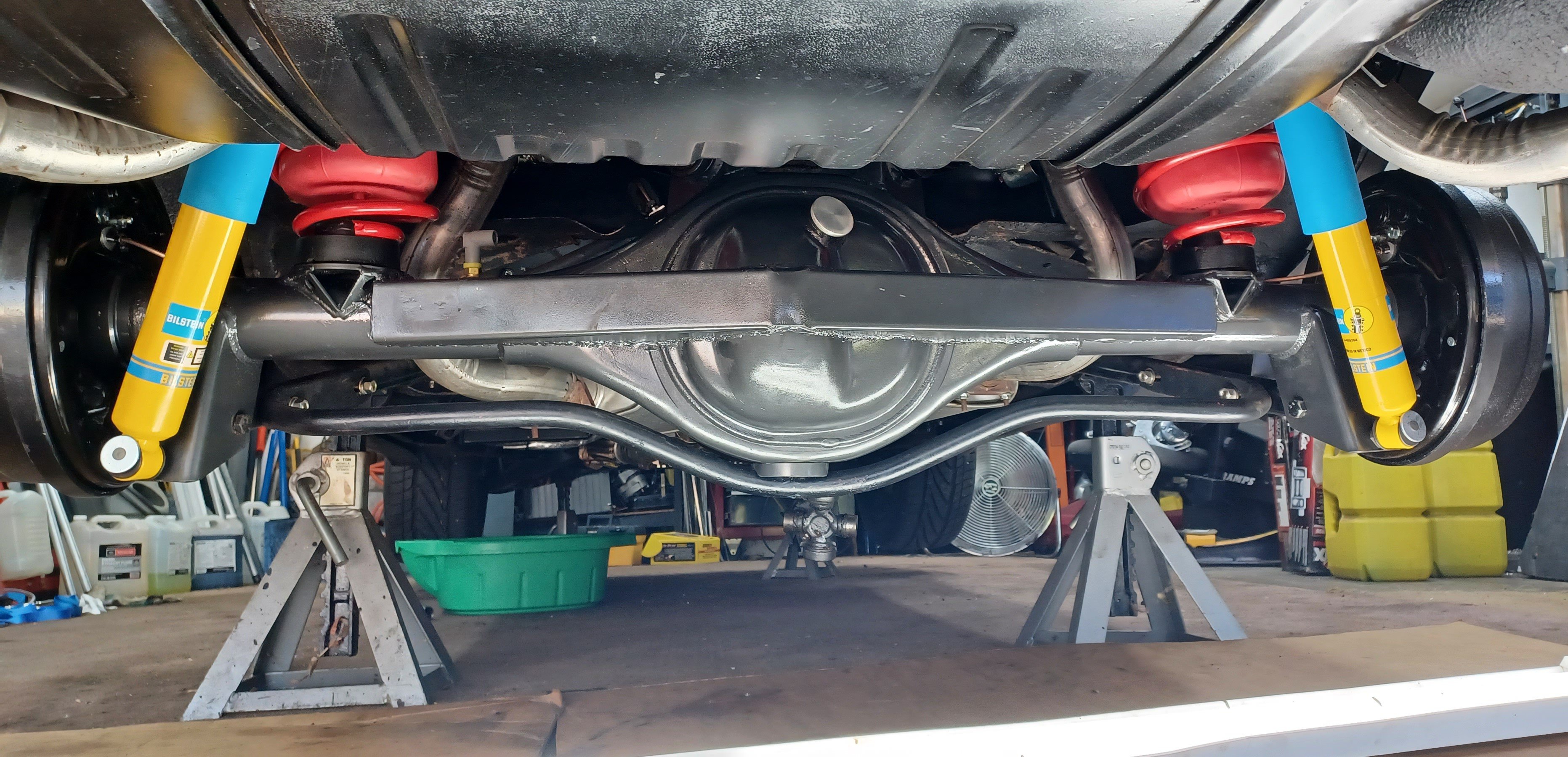

I actually ran the stock bar with these plates for a while to keep it off the housing 20241221_160037.jpgtill I had to $to get the aftermarket bar.

Looks like it does give some adjustability for sway bar position. Just want my sway bar out from under the rear end so I can use the jack plate on the 9 inch. Those clamps might be to small for my axle tubes

I can only speak to the umi set up but they offer it based on your tube size..price wise i can see the cpp vs the umi(i bought mine at their xmas sale in 2014,what i paid's lost on me) but after seeing the end link bracket set up that cpp offers, the Umi is way less convoluted.it attaches to the rear crossmember straight up with a single Heim joint and small bracket. The bar is shorter by design and I'm sure there's some kind of leverage/science with that but I'm not that guy.it has three settings and the directions are pretty straightforward for folks like us.20241222_085532.jpg
When I installed my QP 9" in my Regal my old sway bar was hitting the jack pad so instead of buying a different bar I notched the pad for clearance and then made a wood block with clearance for the bar to use on my floor jack.

I ended up using the axle mounting brackets from my HR Parts n Stuff rear sway bar as they were a lot more robust & beefier than the flimsy U bolt & bracket set up supplied by UMI
