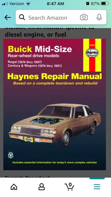

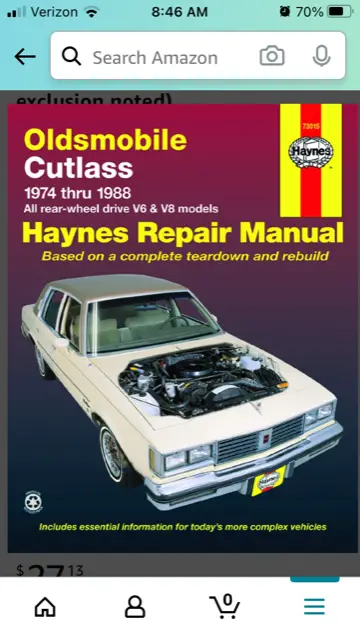

Thanks for all the input!!!
I purchased these manuals yesterday. I'm hoping to get images of core supports (etc.) and THEIR differences. Do y'all have any other manual recommendations?
Thanks!

View attachment 161703View attachment 161704View attachment 161705View attachment 161706
Not to be a Debbie Downer, but those are the worst manuals for comparison. I would be looking at info packets from GM Heritage or original GM service manuals and the specific GM parts books.

Well. Speaking from experience, the Chilton/Haynes stuff is "alright" as its very very basic, very "overhead" type of view of things. As you can see those books cover at least 3 different eras of cars (69-ish, 73-77, 78+), and inside I doubt you'll find a lot of specific photos of what you're looking for, i.e. firewalls (for whatever reason that's important idk) ... It's a whole lot of generic info and not much specific. The photos IIRC (I had the Cutlass book way back in the day) are just generic ones. If you've never touched a car before, they'll get you started at least.
If you really want to drill down and get into the hairy mess of specifics, you need:
  • The Factory shop manual for a specific Make/Model/Year, that covers electrical/mechanical stuff
  • The Factory Fisher body manual for a specific Make/Model/Year, that covers (wait for it) body and trim, glass, interior, etc.
  • and the parts catalog that contains the year(s) you're needing. This will be make and sometimes model specific depending on the year.
And even those will not have a ton of *photographs*, mainly functional drawings or "stock" photos of parts and tools, etc. They also won't cover the highly specific variations that exist, the parts books might list them but probably won't show much.
Best of luck
Be careful of the Fisher Body manuals as well. Sometimes they use "generic" photos of assemblies that could be 15 years older than what they're describing in the book. Or even of some other model, but used for "reference". So the Fisher book isn't always the best either.
