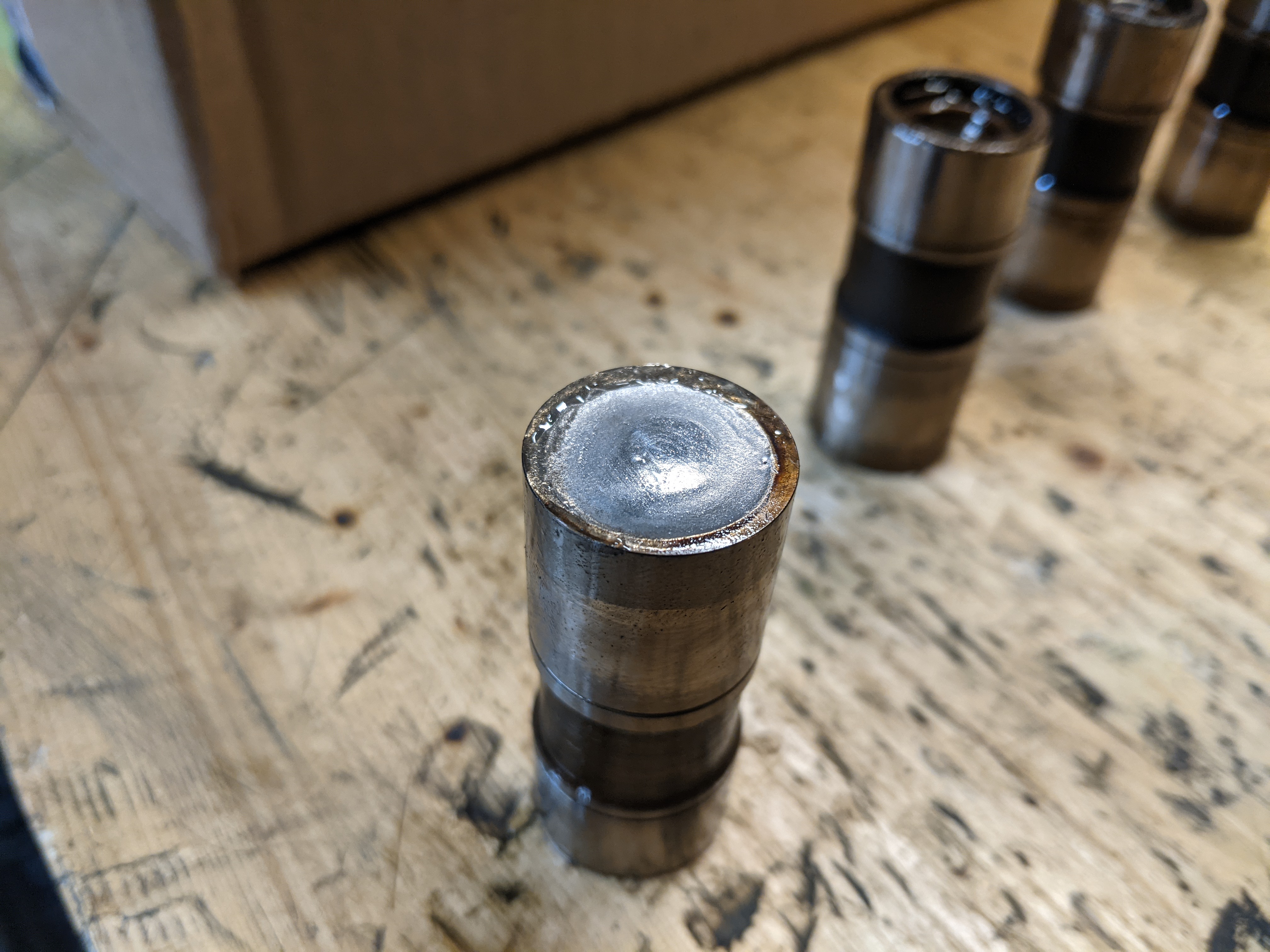

Hello everyone, my Buick 3.8 is having a hard time. The engine hasn't ran in a long time and I recently replaced the head gaskets but I just can't seem to get it to run right. The idle is really choppy at 15° timing and smooths out when I drastically increase the timing. It won't idle below 1000 rpm or it will just die and misfires like crazy at anything above 2000 rpm. Any suggestions? Vacuum lines are all new and I'm getting about 17" of vacuum at 1000 rpm. Compression tests shows 130-110 psi
Sorry guys for posting and not following up. I measured the valve lift of each cam lobe with a dial indicator at the top of the pushrod with the rockers removed and found #5 exhaust lobe lift to be .100" lower than spec so I'd imagine this is where my problem is

Lifters are all solid so I think it's a cam lobe. The cam lift is normally .240" and I measured .143". I recently did the head gaskets and cleaned up and lapped all the valves at the same time so I'm betting on the cam lobe. And my carb is the stock dualjet 210
You can see how round the lobe is in this picture (second from the last) and the lifter has uneven wear. Looks like I will be replacing the camshaft and lifters
