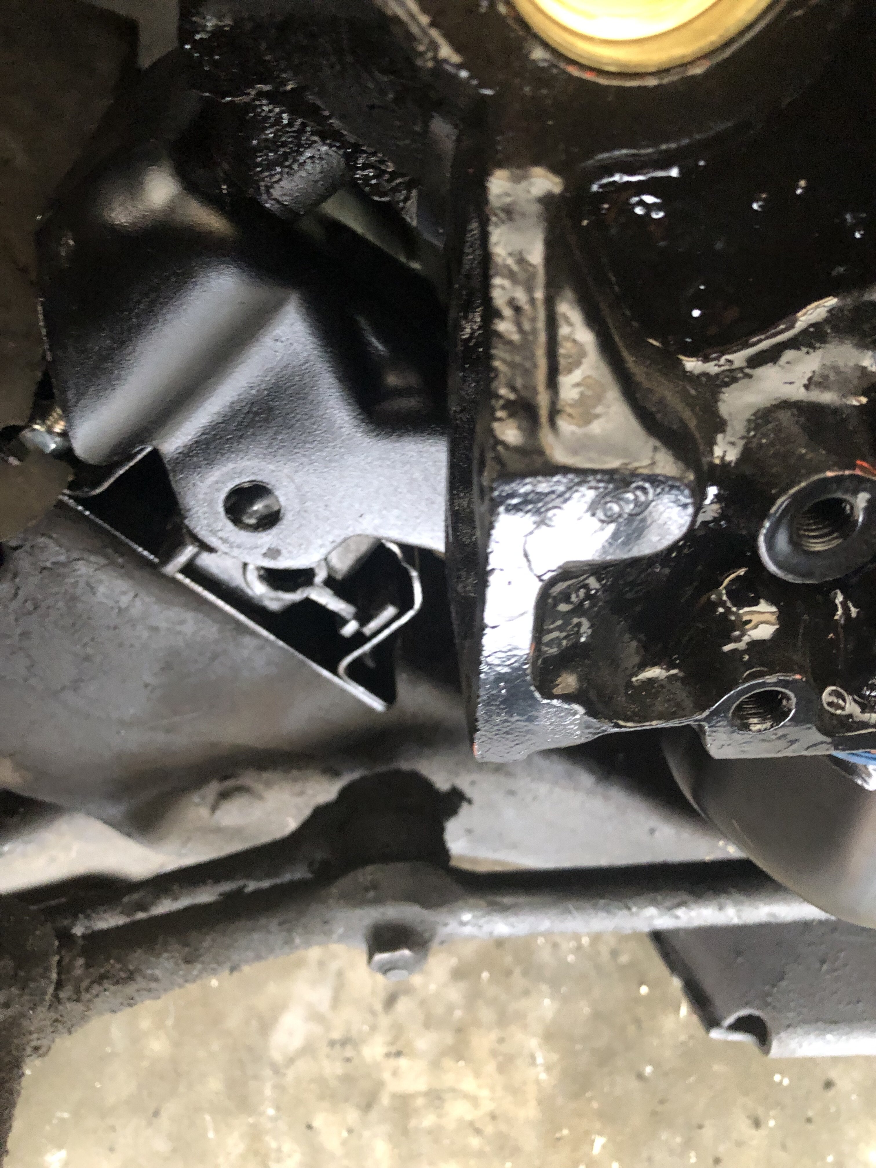

Okay thanks. The through bolts I got are 3/8 but seems could be a little bigger. Should I use 7/16?
edit: lots of reviews on the summit page for the OER mounts says they used them in a g body. I will try to mount them on the block tomorrow. They fit the clamshell perfect.
These didnt work because the engine plate is too wide for the clamshell.

These didn’t work either. Too wide.
Almost identical to the 2nd gen fbody OER mounts
Look real carefully at your frame side mounts, they look like they're in upside down?
If you look the rubberized insert on the frame side mounts are down low almost to the bottom of the outer shell. If they were flipped around, they would be sitting higher up and look like they would line up with the engine side mount through bolt holes?
Am I missing something? Could your frame side mounts rubber insert bushings have slid down, or torn from the weight of trying to maybe force the engine onto them while in upside down?
Just basing on what the pics seem to show...

I went back and looked at the pics of the frame mounts on mine, and they are 100% original GM OEM ones I bought new back in 1989. They're actually still available (original part # 459021) but currently # 22188497
Anyway, what I noticed was that the rivet that holds the two halves of the metal around the rubber bushing (top and bottom center) has different alignment with the bolt holes that attach to the frame crossmember.
Notice the top rivet is in a straight light with the two top bolt holes, and the bottom rivet is below that plane of the two bottom bolt holes.
I guess this could be a way to confirm you have those frame mounts oriented properly?
Maybe I'm just reaching at straws, and way off....wouldn't be the first time. 🤔
