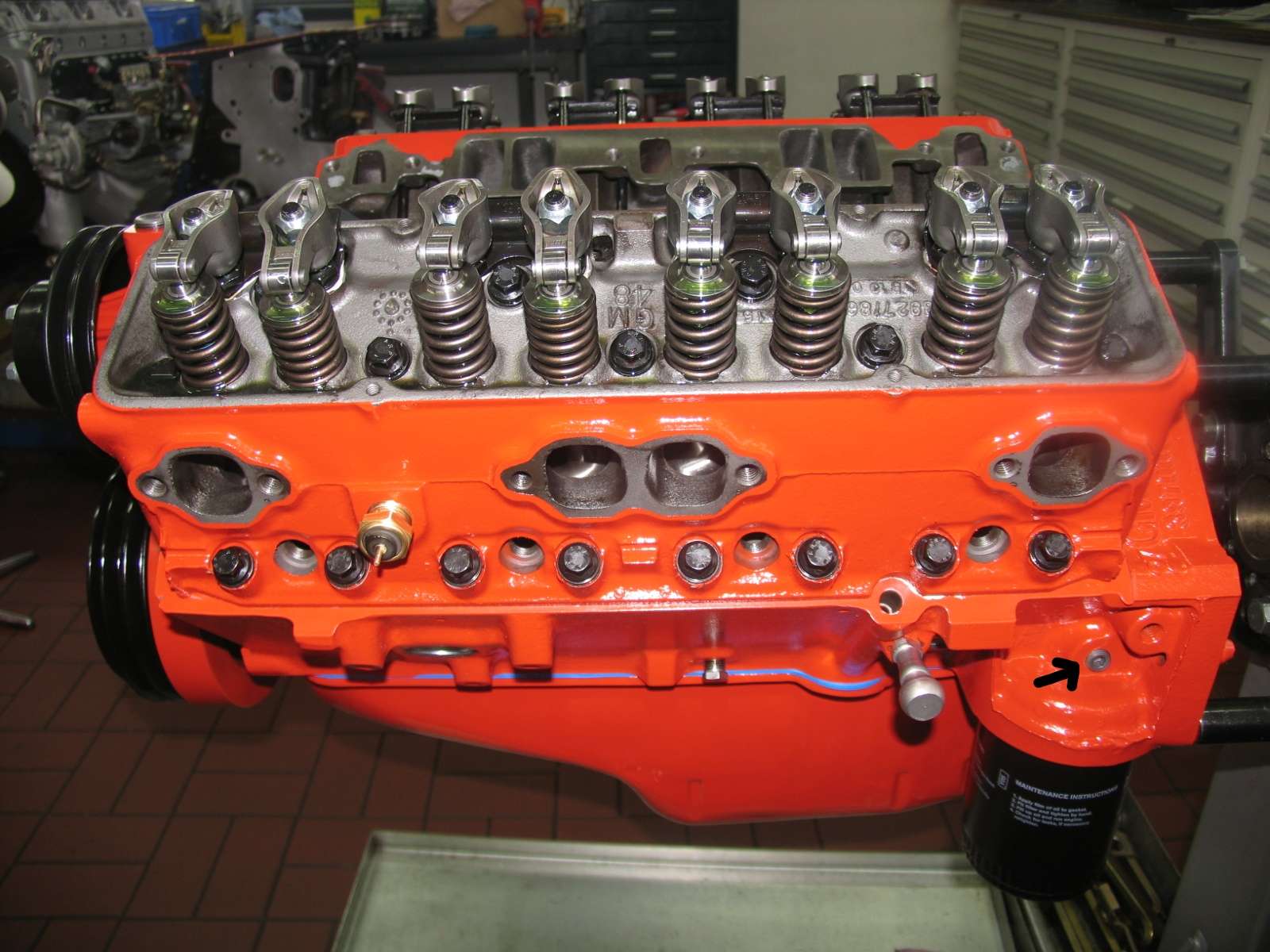

Have to ask... Do you have a plug or sending unit in the oil port above the filter housing on the side of the block? (Black Arrow)
Easy to overlook the plug being installed or break the sending unit while working on the engine.
