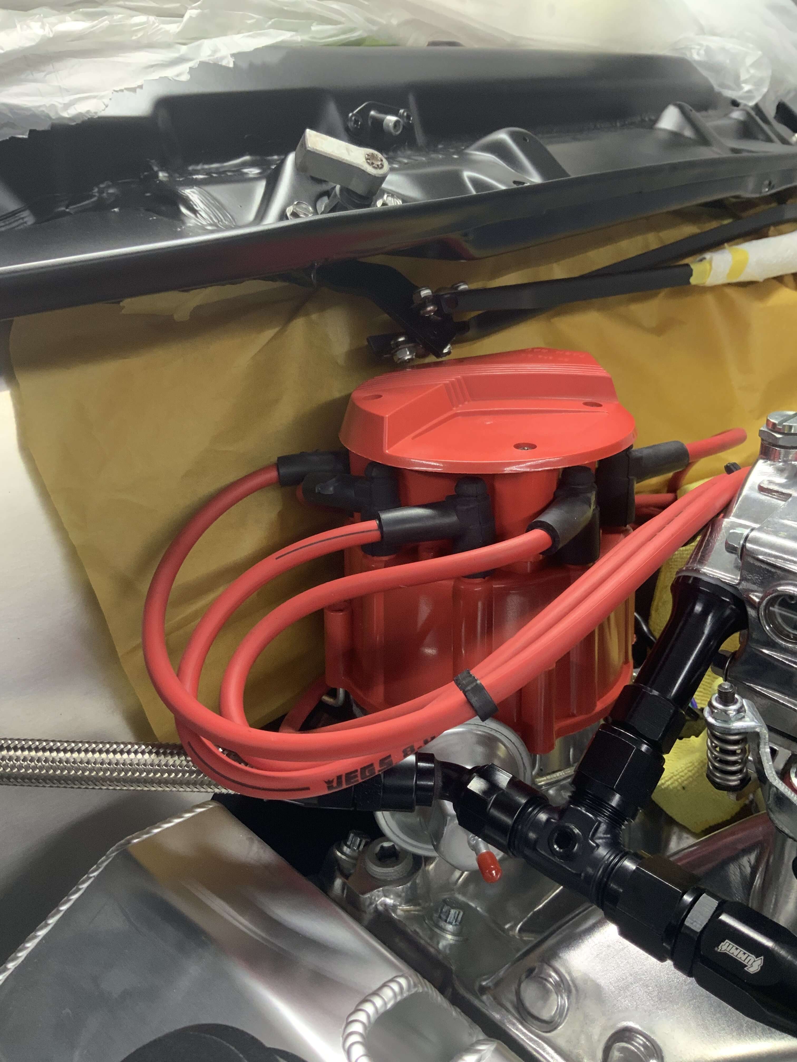

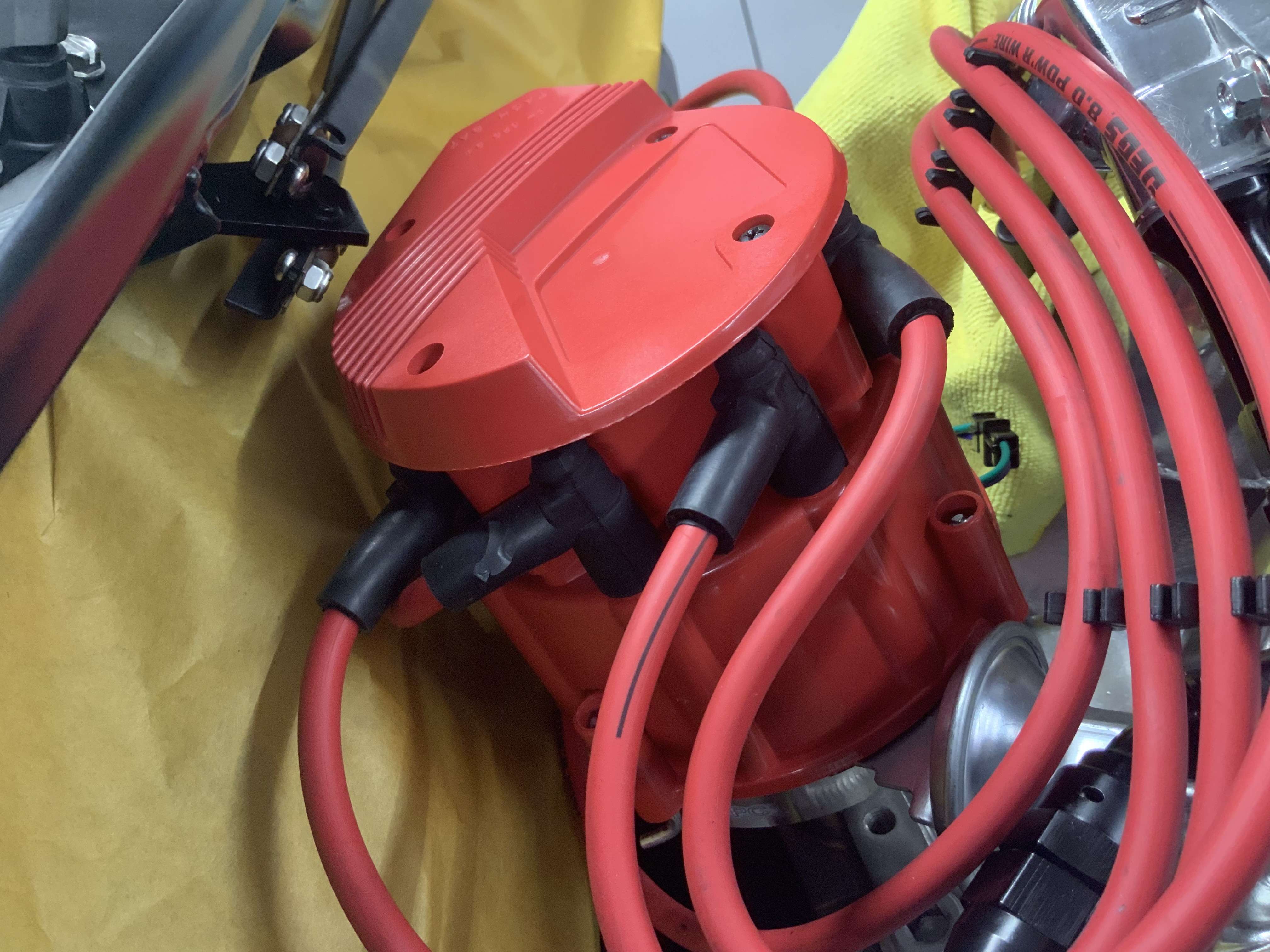

So I put my windshield wiper set up together come to find out it doesn’t clear this distributor. So Chevy HEI distributors don’t fit gbodys? Is it only Chevy gbodys? Has anyone ran into this situation?3150C278-3FE3-4C85-8313-90E37D78A688.jpeg797EEAAB-5A4B-486D-A72F-10B28B4B8A65.jpeg
Reactions: Tony1968
So I put my windshield wiper set up together come to find out it doesn’t clear this distributor. So Chevy HEI distributors don’t fit gbodys? Is it only Chevy gbodys? Has anyone ran into this situation?View attachment 215981View attachment 215982
When I first installed my SBC in my Regal I had this style coil cover on a stock replacement HEI and it cleared the wipers no problem, later I changed to a full MSD set up, so maybe change the style of coil cover .
