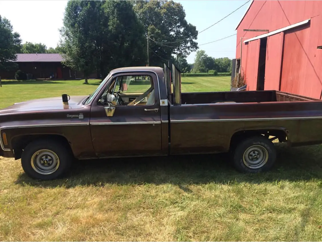

In other news I got off at 3:30 for the first time today and it was awesome! Went to Industrial Welding Supply in Lakewood Industrial Park to do some research on a new Lincoln ranger ha ha that's not going to happen with all the $3, 000 modules it would take to make the ranger do what mine does I'd be into it $13, 000 so I'm going to hit Airgas about a Miller because the Lincoln people seem to think that my red-d-arc was actually made by Miller. The truck took me everywhere without getting to hot to so I'm starting to regain my trust in it
What did you do to the cooling system?
