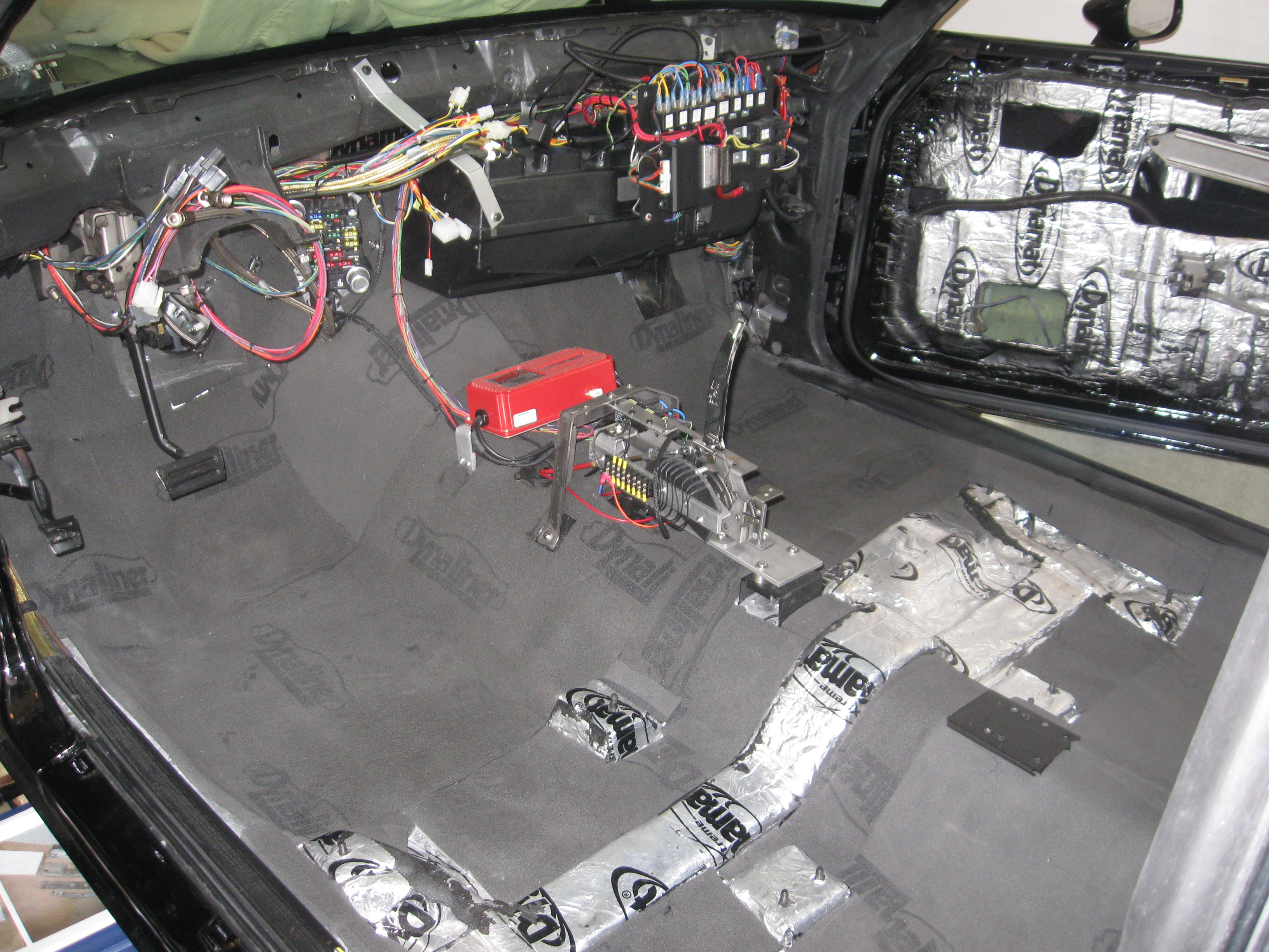

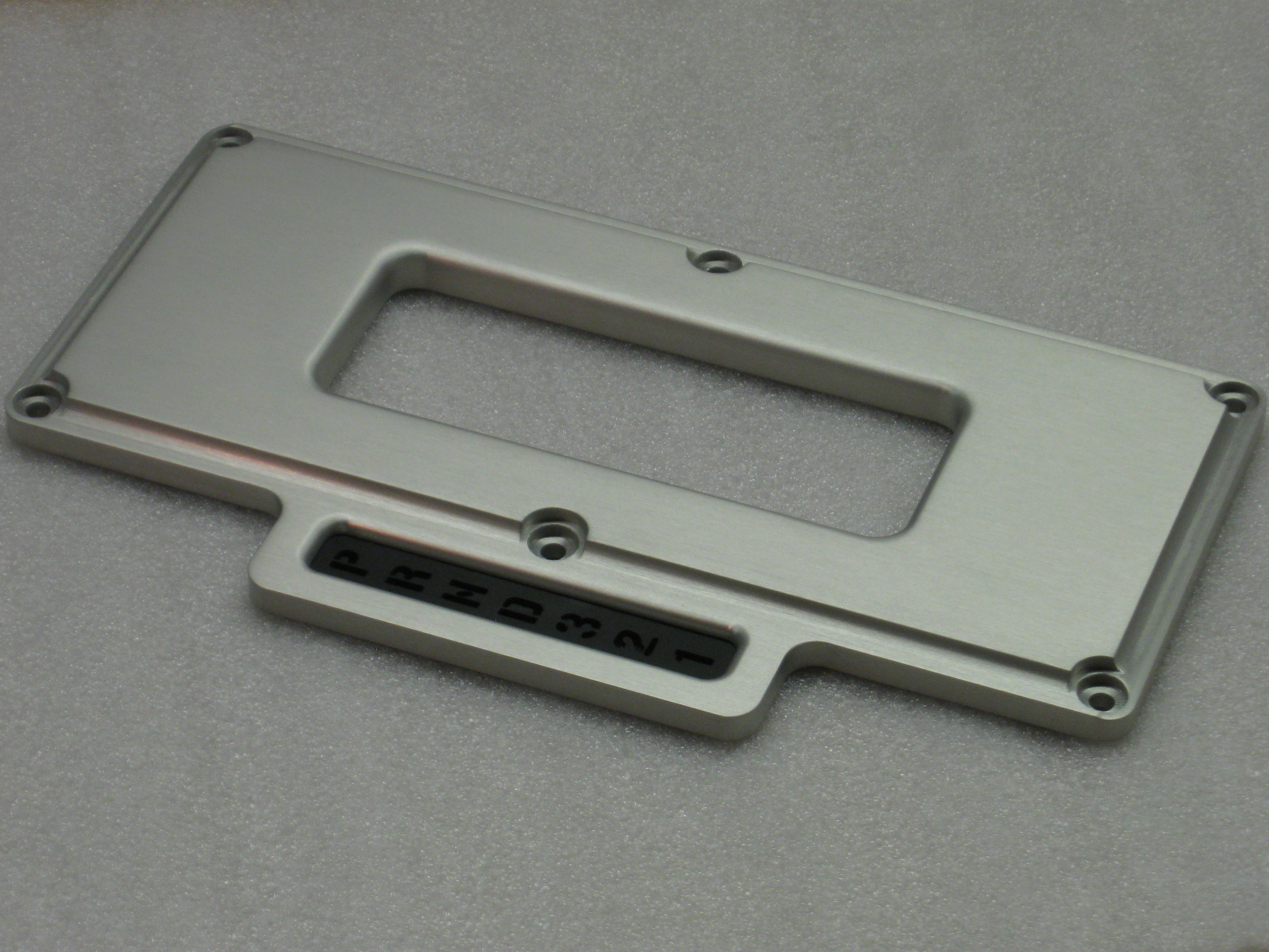

As you requested, here are a few pics of the mod. Ignore the wiring on the shifter in pic 1 -- it was a temporary setup to test out the shifting. I've since implemented a Shifter Decoder that senses the shifts at the transmission (Lokar Indicator Control Module CINS-17002). I use this decoder to light up LEDs in the billet shifter plate (pic 3) that I have machined to display shifter gear selection. It's also used to sense Park and Neutral -- prevent starting (i.e., Neutral Safety Switch) -- as well as to activate the backup lights.

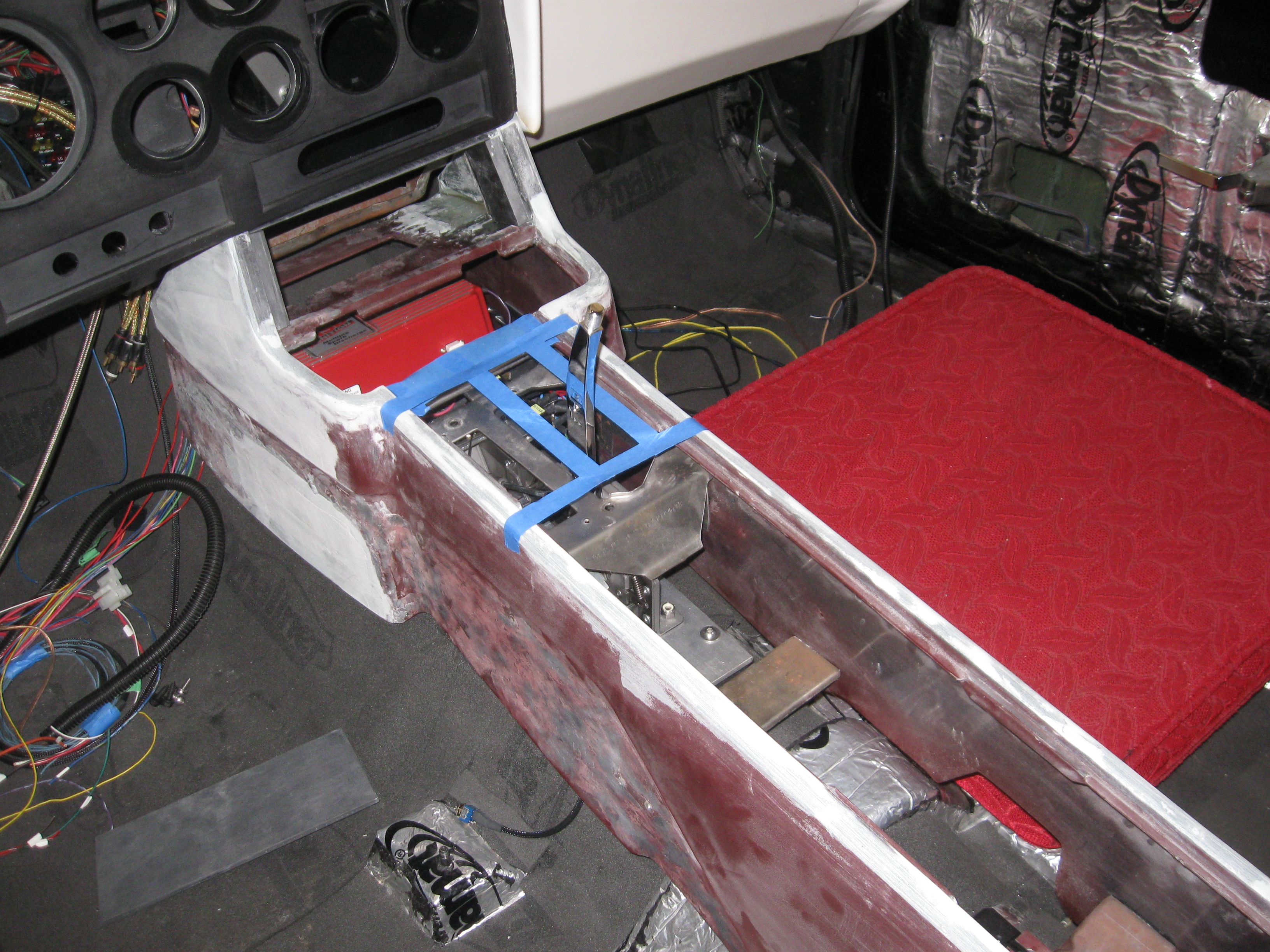

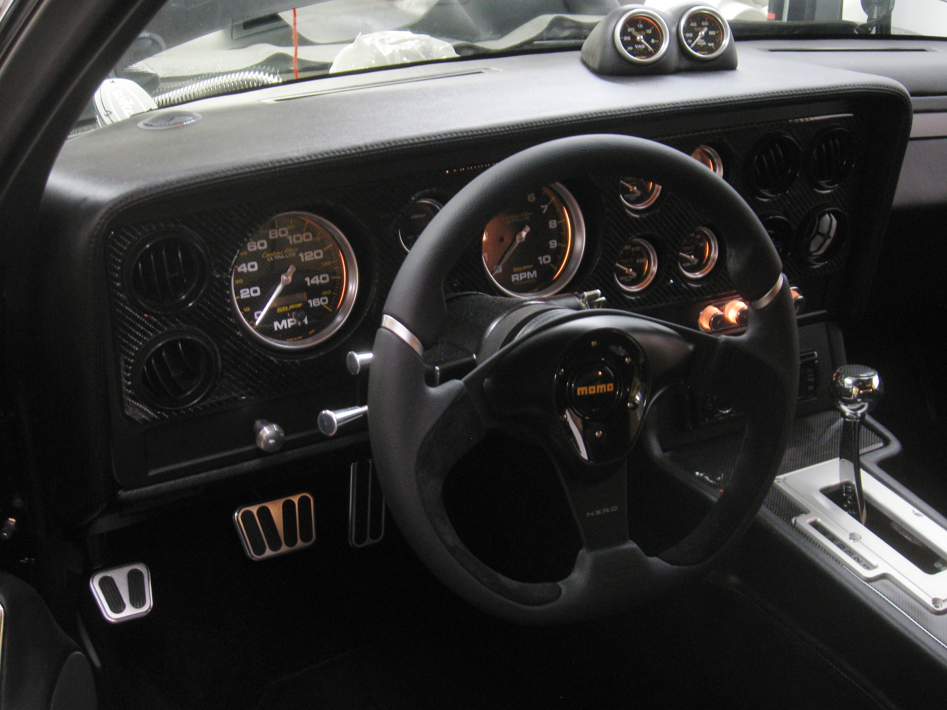

I re-used most of the OEM shifter bracketry to mount the B&M shifter (pic 1), with some minor modifications. Even though the console itself is somewhat modified in front of the shifter, everything back of the blue tape (pic 2) is pretty much original. The main reason for the customized bracketry is to ensure that the B&M shifter sits at proper height in the console. It's possible to mount the B&M shifter to the floor bracketry without all this customization -- I'm just somewhat "anal" with this car .
